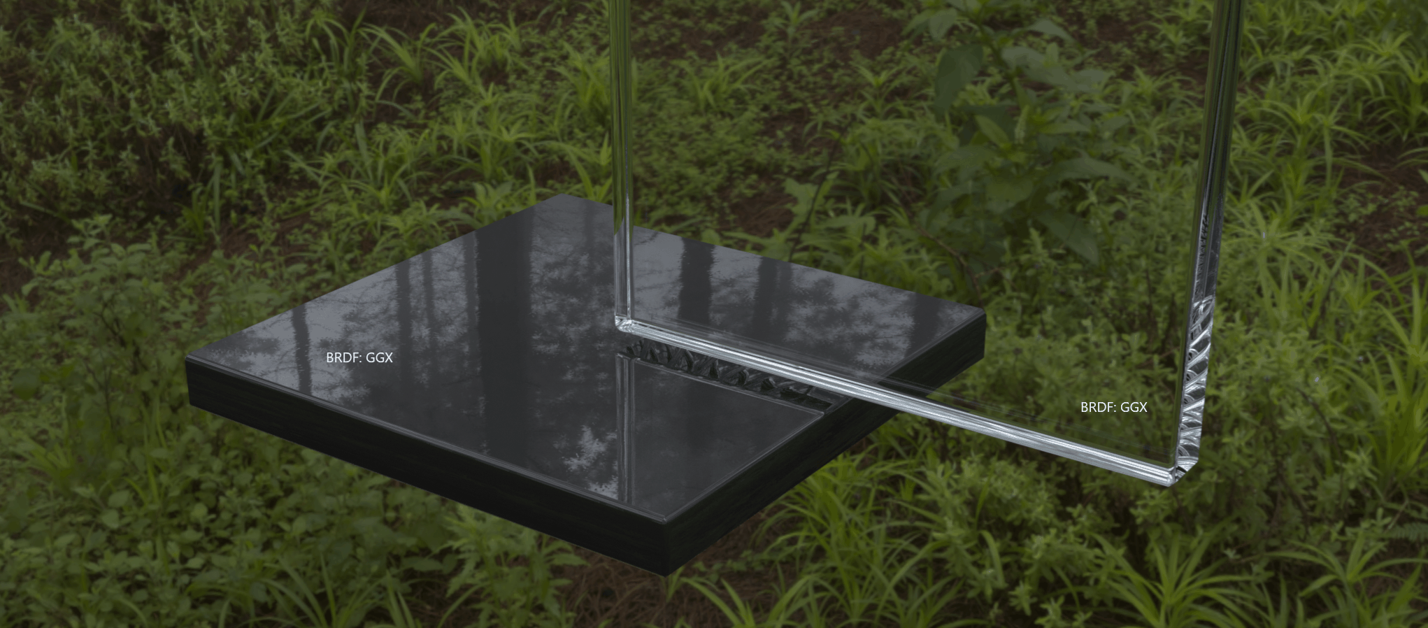

thanks for the screenshot, I’m not totally sure to have correctly understood the geometry, but it seems to me that the gxx effect is already present on the right, and if the specular is also in gxx mode, the same effect is repeted also on the left, since it is not changed from the different BRDF model.

bepeg4d wrote:Hi,
:roll:
The attachment 8C45F09A-0E56-455A-A400-DD83332CCD2C.jpeg is no longer available
ciao Beppe
Ok, maybe that's just the way it's supposed to work and I don't know enough about BRDFs. Anyway, I prepared a test orbx, here: https://we.tl/tDw1s3ZfkC
I hope that helps and thanks!

DigiChuckle wrote:
bepeg4d wrote:Hi,
:roll:
ciao Beppe
Hi there DigiChuckle, this is an interesting find.
Seems like the new materials like the Backman, GGX and Ward in indirect rays see the caustic blur (that supposed to only be visible for diffuse rays)
So as workaround you could set your caustic blur to a smaller value. This has an direct effect on how the reflection roughness of the glass is looking in the render.
This is probably something that should be addressed by the main devs!
@aoktar would you please pass this along to the devs, so they can have a look at it!
(Only happened when you have a scene where you have both the old BSDF and the new BSDFs mixed)
WIN 11 PRO 64 | ASUS X299 SAGE | 1X RTX 4090 3X RTX 3090 | i7 10980XE | 128GB RAM
Posts: 10536
DigiChuckle wrote:
bepeg4d wrote:Hi,
:roll:
ciao Beppe
thanks for the scene, I have forward it to the SDK devs.
ciao Beppe
