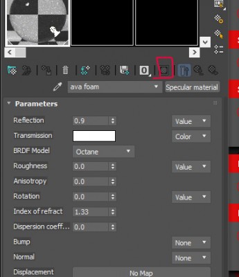

try to hit preview in viewport when you go inside the RGB texture. maybe it will help. In itoo 5 it fixes grey objects bug
