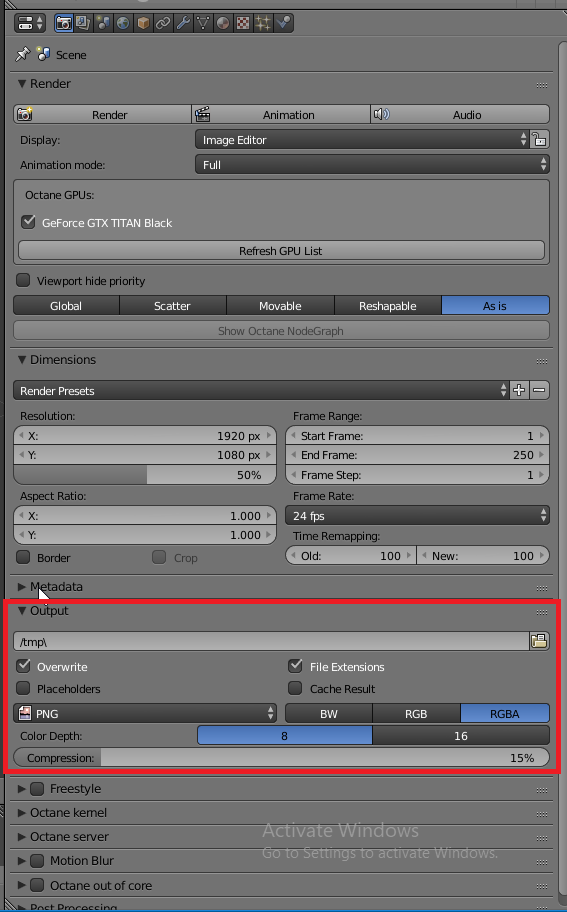

Ok, I think I got it. My file otput was to project root "//"
If it's set to existing location it does not crash.
