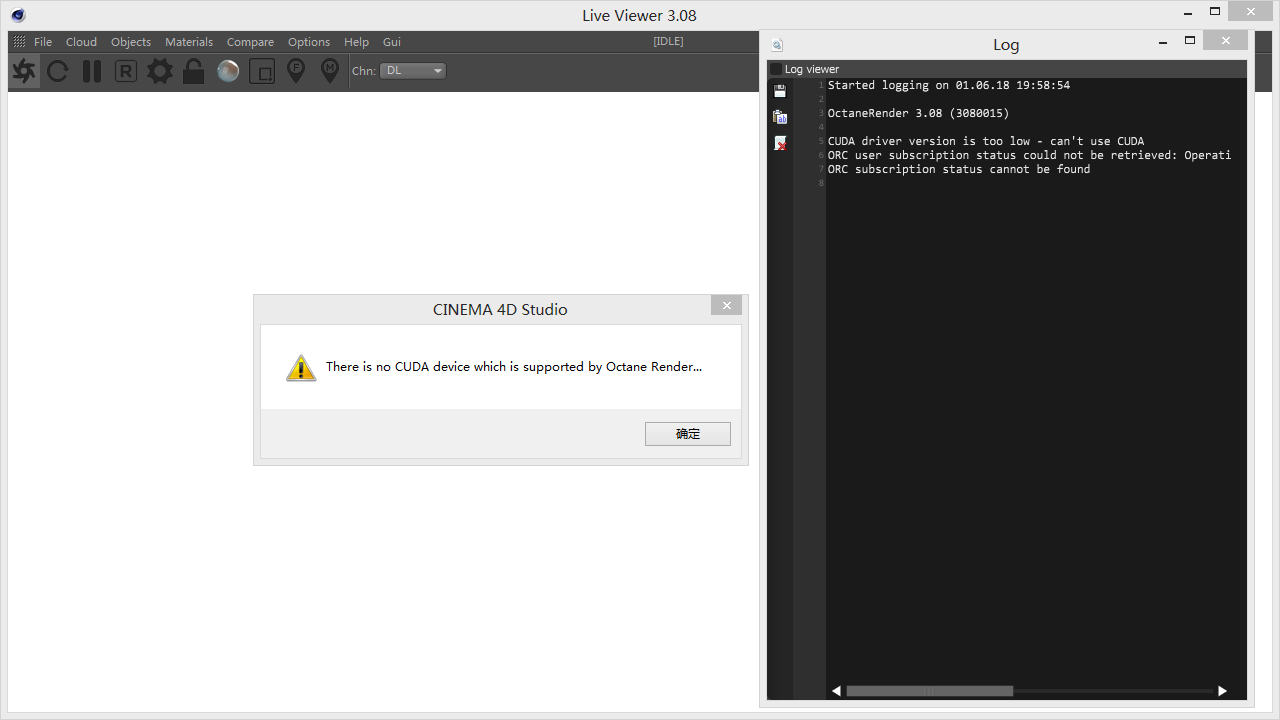

Hey Guys,
I'm using octane with C4D.

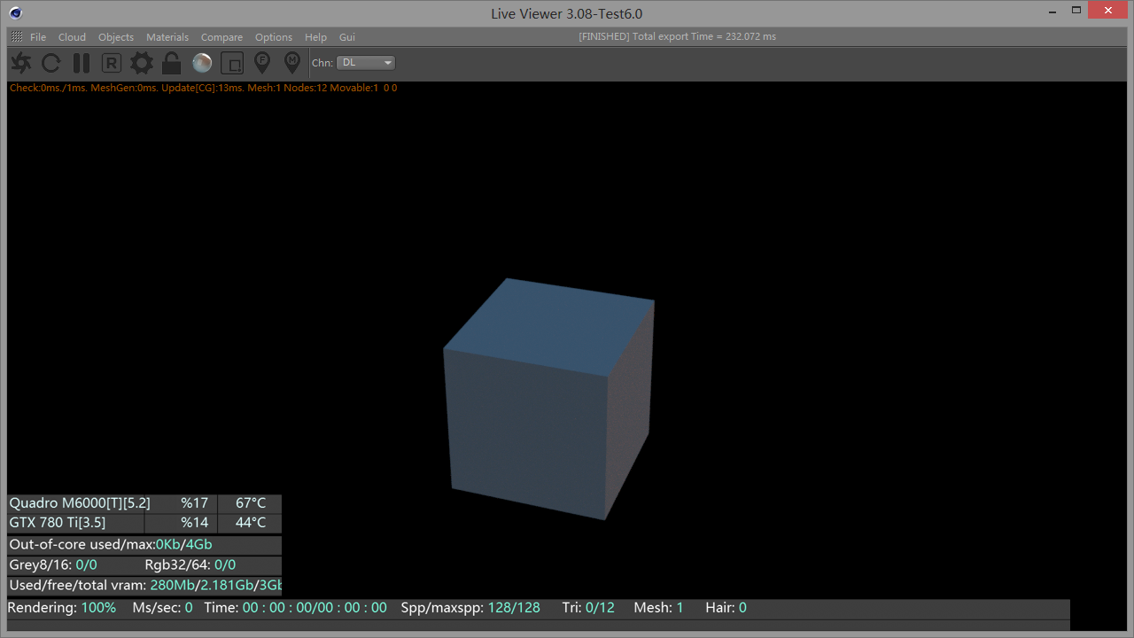

When I use version 3.08-Test6.0 for C4D R19 in windows 8 x64, Everything is normal. It's normal in 3.07.0 R2 too.
But in version 3.08, The problem happened: There is no CUDA device which is supported by Octane Render
Even if I upgrade to the latest driver, it doesn't work.
I can't use the new version now.
Thanks in advance for your help.

Hi wildfrog,
you would try using Nvidia 388.13
http://www.nvidia.com/download/driverRe ... px/126255/
Performed clean installation procedure using Download Display Driver Uninstaller DDU
http://www.guru3d.com/files-details/dis ... nload.html
Regards
Paride

Hi paride4331,
Thanks for your suggestion, while the drive you provide is for Windows 10, it‘s incompatible with my system - Windows 8.
The earliest version I can find is 388.43, it is equally effective.
Thanks again.
