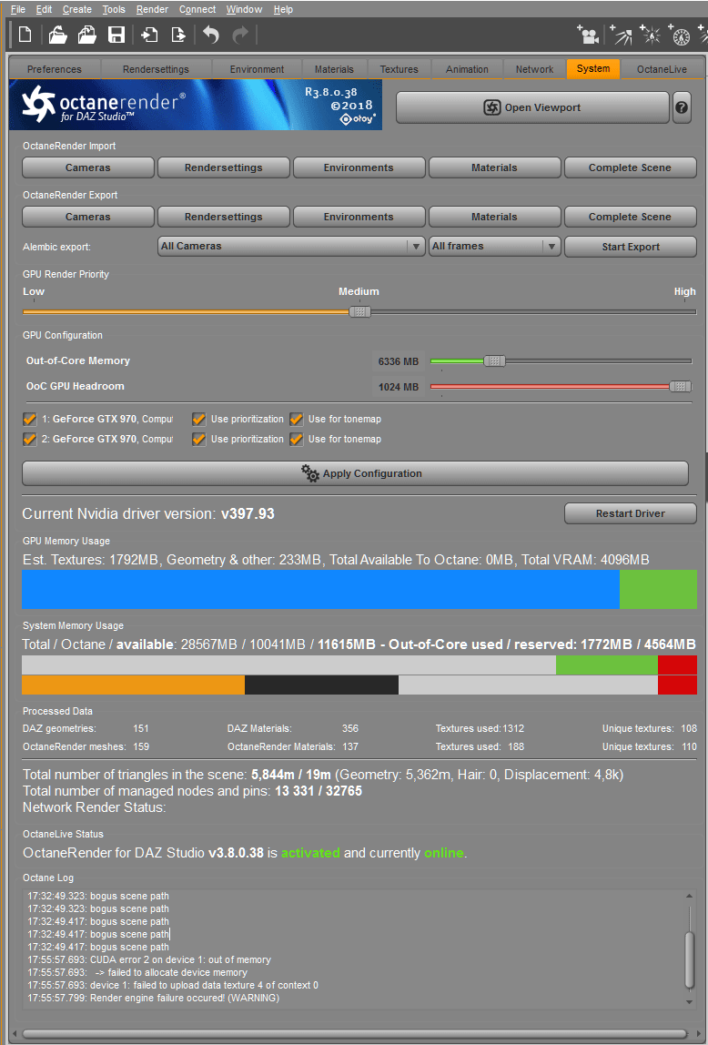

11:10:55.006: CUDA error 2 on device 1: out of memory
Hi Thomas - it looks like you are running out of VRAM. Have you got out-of-core textures turned on? What are your system and graphics card specs pls?
Paul
Fanthomas
Posts: 18
Joined: Thu Jul 28, 2011 6:33 pm
Location: Austria, Burgenland
The data is actually in my signature anyway, out-of-core memory, I put on highest setting, but this setting is zero after each restart.
But even in the full out of core attitude, I had the problem.
Now I have returned to version v3.7.0.37 with the same old Nvidia driver v390.65 and this works so far without problems.

It is saying it's running out of VRAM. 4GB is not enough to handle the geometry and textures you are using in the scene (together with the overhead that Windows requires).
