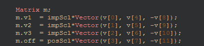

Check this quote from my codes
chrisw69
Posts: 5
Joined: Sun Feb 18, 2018 10:31 pm
That's brilliant thank you!
