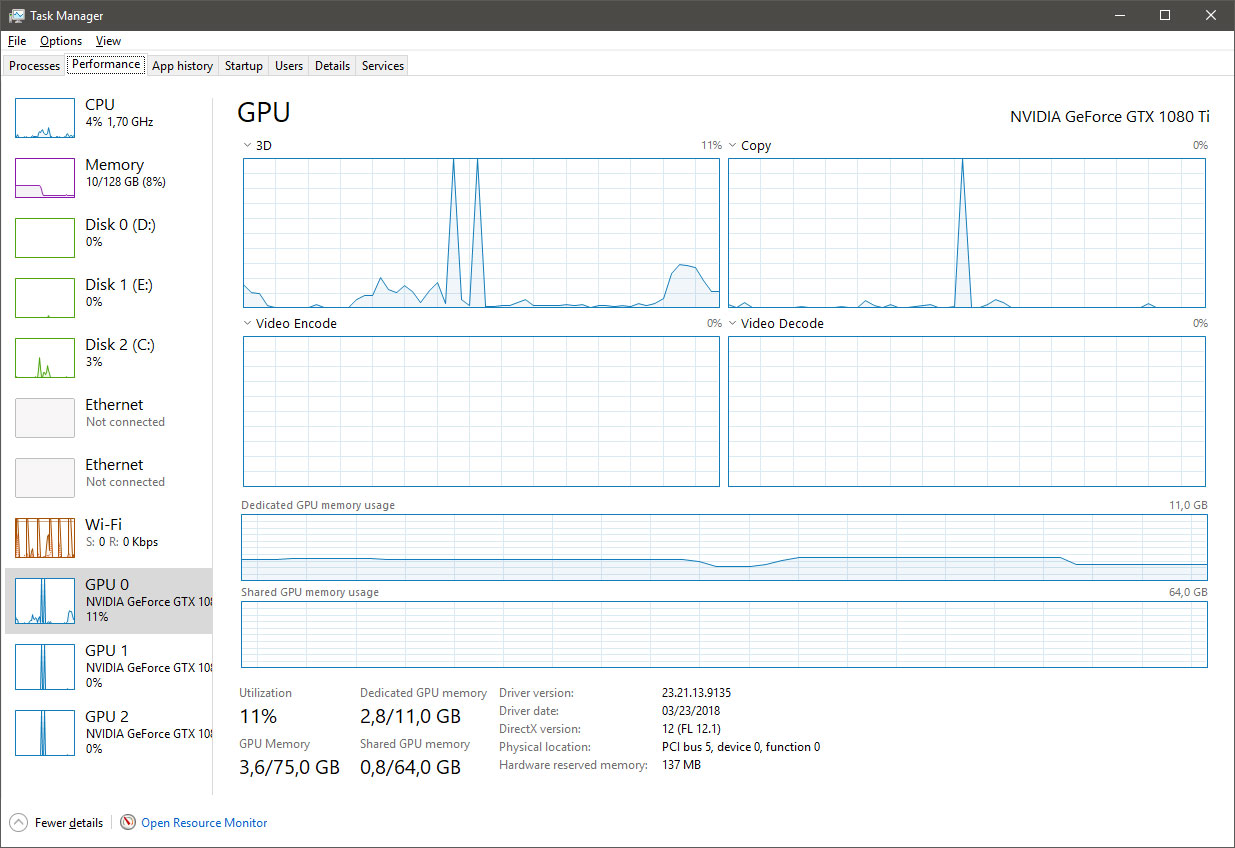

Postby crozer » Mon May 28, 2018 9:44 pm
crozer Mon May 28, 2018 9:44 pm
hi,
because the task manager says so. i did not know that these reports are not correct? (see image)
*edit: when using the IPR it also displays only one GPU (the image attached was captured while on IPR)
perhaps i should also mention that i get a lot of 702 gpu-memory errors. sometimes it happens when i'm running the IPR, and i use an app on my other monitor (eg. netflix, spotify).
windows 10, houdini 16.5.268 and octane 3.08.1 (plugin: 3.08.1.0)
thanks!
crozer
Posts: 4
Joined: Fri Apr 15, 2016 1:52 pm
Re: Octane render-to-disk only using 1 GPU?
Postby juanjgon » Mon May 28, 2018 9:53 pm
juanjgon Mon May 28, 2018 9:53 pm
Yep, these default reporting graphs are not true at all while rendering. You need to select another report from the drop-down menu to check the GPU rendering utilization, for example, "Compute_1".
Postby crozer » Mon May 28, 2018 9:59 pm
crozer Mon May 28, 2018 9:59 pm
juanjgon wrote:Yep, these default reporting graphs are not true at all while rendering. You need to select another report from the drop-down menu to check the GPU rendering utilization, for example, "Compute_1".
Hope this helps,
-Juanjo
hi juanjo, thanks! which drop-down are you referring to?
and would you have an answer for the 702 issue?
crozer
Posts: 4
Postby juanjgon » Mon May 28, 2018 10:11 pm
juanjgon Mon May 28, 2018 10:11 pm
Click where you can see "3D" or "Copy" labels in the top of the graphs. There you can select what kind of report do you want for this graph.
I'm not sure about the 702 problems. if you say that it happens when you have another application working while rendering, perhaps the problem could be related to these applications that are using some of the GPU memory not leaving enough for Octane ... it is hard to say. If you want to attach the log file that you get after one of these crashes, I could take a look at it here.
