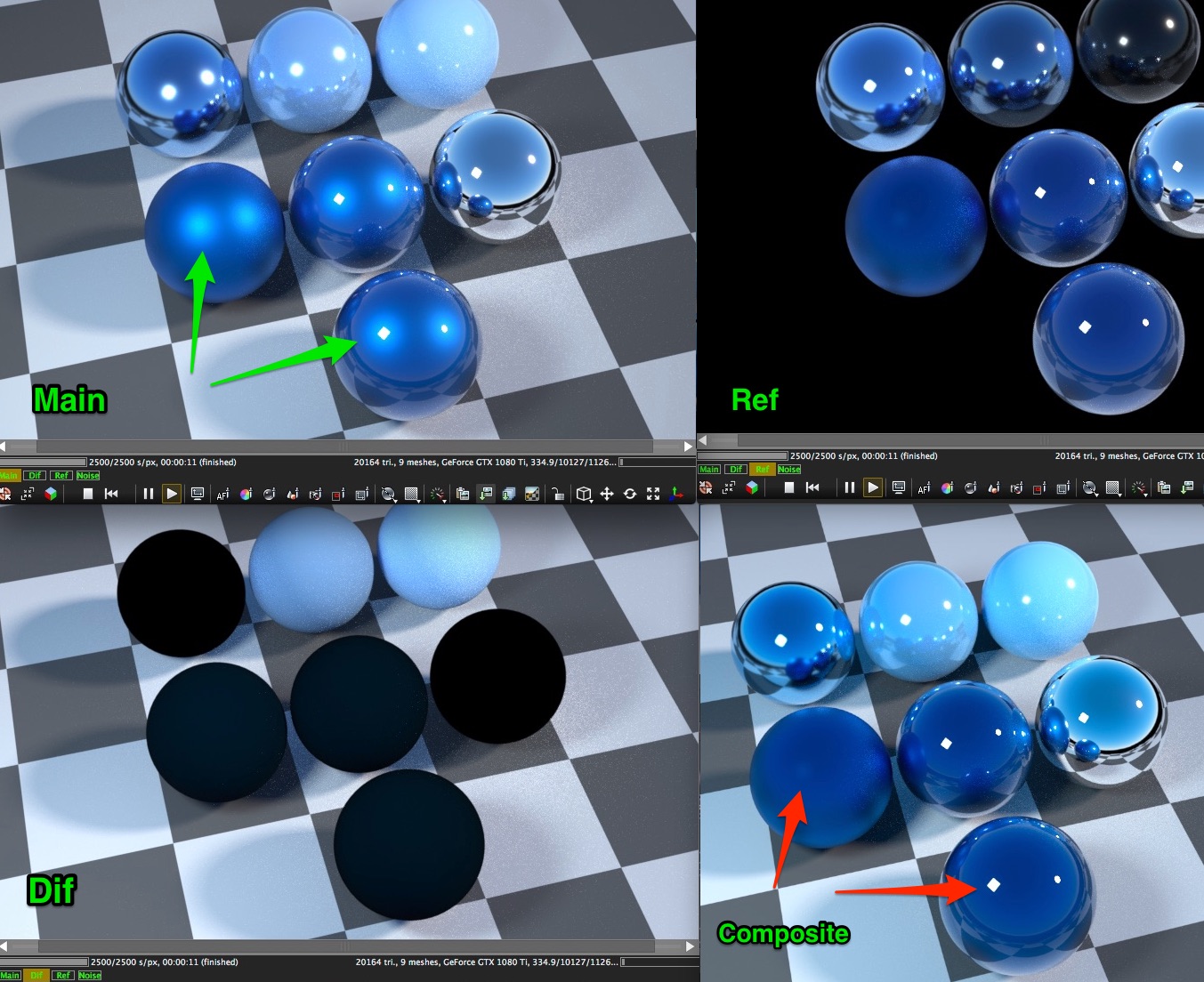

I'm missing something when it comes to the new metallic material and beauty passes.
With glossy, I'd just use a couple mix materials and render Diffuse and Reflection Beauty pass.
With metallic, I'm following a similar procedure, and while it looks similar (but better) in the preview, I seem to me missing a render pass to get the full composite.
I flipped through the other passes to see if there was something I was missing, and didn't find one.
See the attached, the composite is missing the bloom around the light source that is seen in the main.
I've also attached the OCS seen as exported from c4d
Any help appreciated

yes, confirmed, there is an issue that is already been fixed for the next 3.08.2 version.
