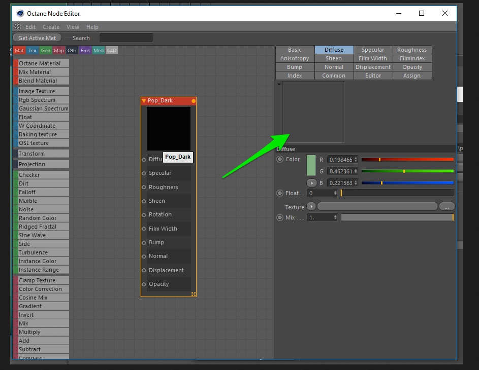

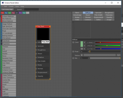

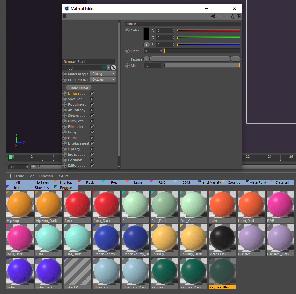

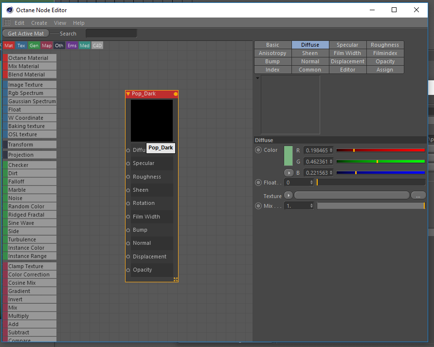

My materials stopped showing up as they should yesterday. If I duplicate one with a preview it's just going to show up as that old preview even though changing diffuse etc. and if I create a new one I just get a full transparent striped one like the one called "Indie LP". Tried switching back to the stable 3.08 but still same problem. Opening the material in the node-editor just gives me a black square. Using latest update for Cinema R18 and 3.08
