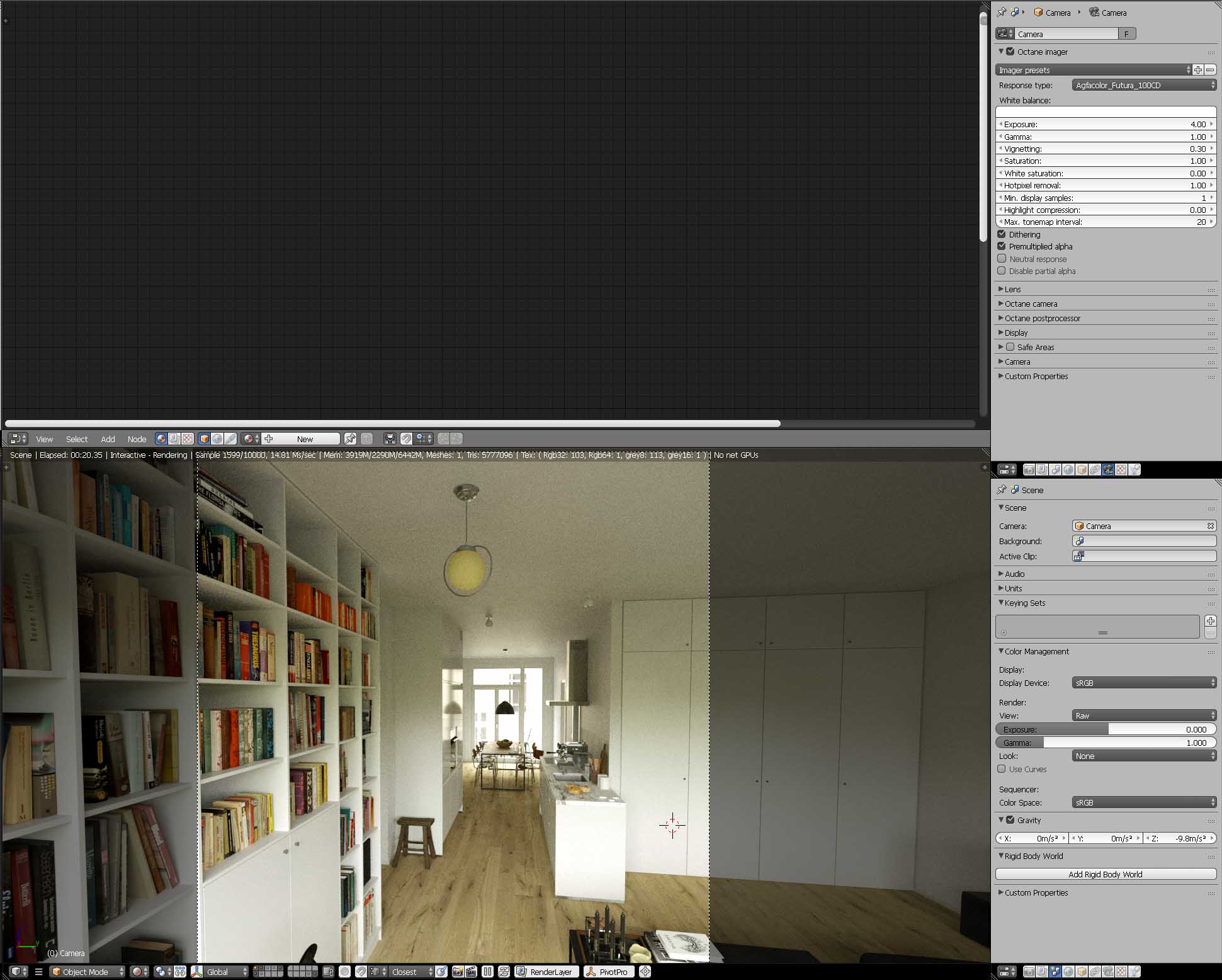

The Look of the rendering is quite different compared to 3.07.
I can't even match by changing exposure.
Although the HDR is set to 32bit/per channel at least the information-bar in the render viewport doesn't display (RGB 64: 0).
In another scene changing imager settings like exposure, gamma, etc. won't update until you move the viewport or update.

Hi aufwind,
Thanks for your report.
I found that you are in preview mode(Ctrl+Z).
In 3.07, we have two camera imager settings, one is in the property panel as shown in your post while the other one is in the view panel(shown below). We use the view panel one for preview mode and property panel one for render mode.
In 3.08, we remove the view panel setting. Both preview/render mode read the setting from property panel.
Therefore, could you please try the parameters in the view panel in 3.07? Thanks.
Besides, we will try to figure out a solution to solve this back-compatibility problem.

Hi Drawfun,DrawFun wrote: I found that you are in preview mode(Ctrl+Z).
thanks for your reply. Yes I'm in Preview Mode, but with the Camera active.
Otherwise the Camera Panel wouldn't show. Changing (greyed out) Parameters in
the Viewport Panel doesn't affect the Render.
I've tried all available Bit depth Settings for HDRI without any change.
