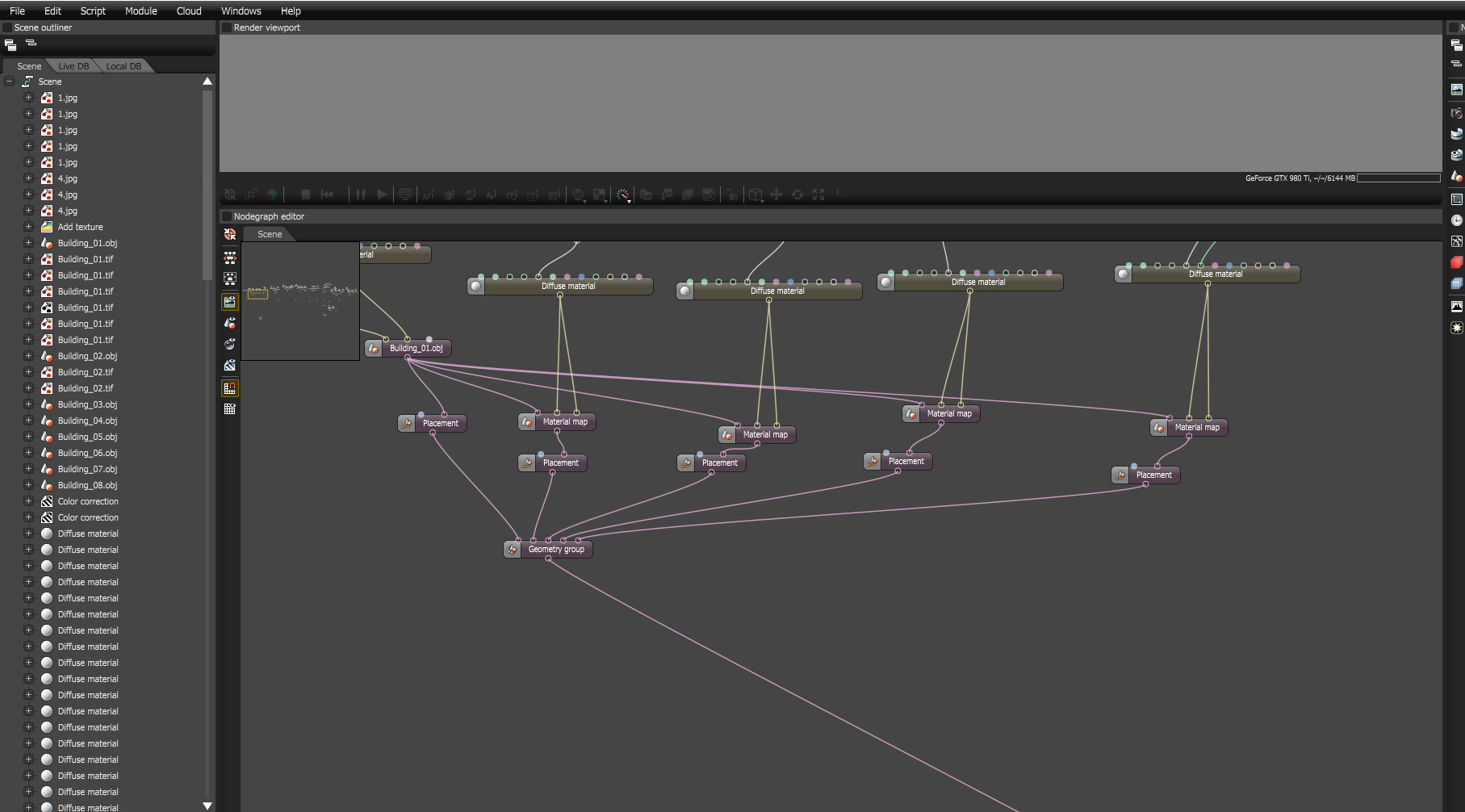

There's a feature request I have, which is not related to the new version. Would it be possible to have the geometry group node and placement node from Standalone available in the C4D plugin? I know that we can mix displacements with the baking node, but the geometry node is faster and easier to use :)

Voltago wrote:Hi Ahmet,
thanks a lot for the new plugin! It's work great for me so far, great job!
First thanks for your comment! But I couldn't understand what you mean on request.

Voltago
Posts: 9
Joined: Mon Aug 15, 2016 8:20 am
aoktar wrote:First thanks for your comment! But I couldn't understand what you mean on request.
Hi Ahmet, please have a look at the attached screenshot. There's a geometrey group node that allows to use several displacement maps on one object. Hope that helps!
