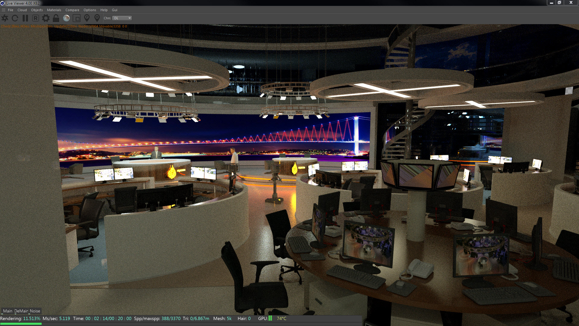

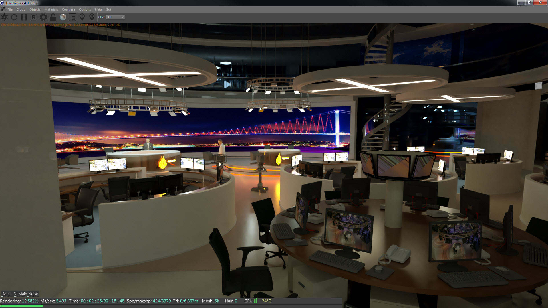

AIdenoiser vs. Normal rendering
							Version 4 - XB2 (Test release1)
