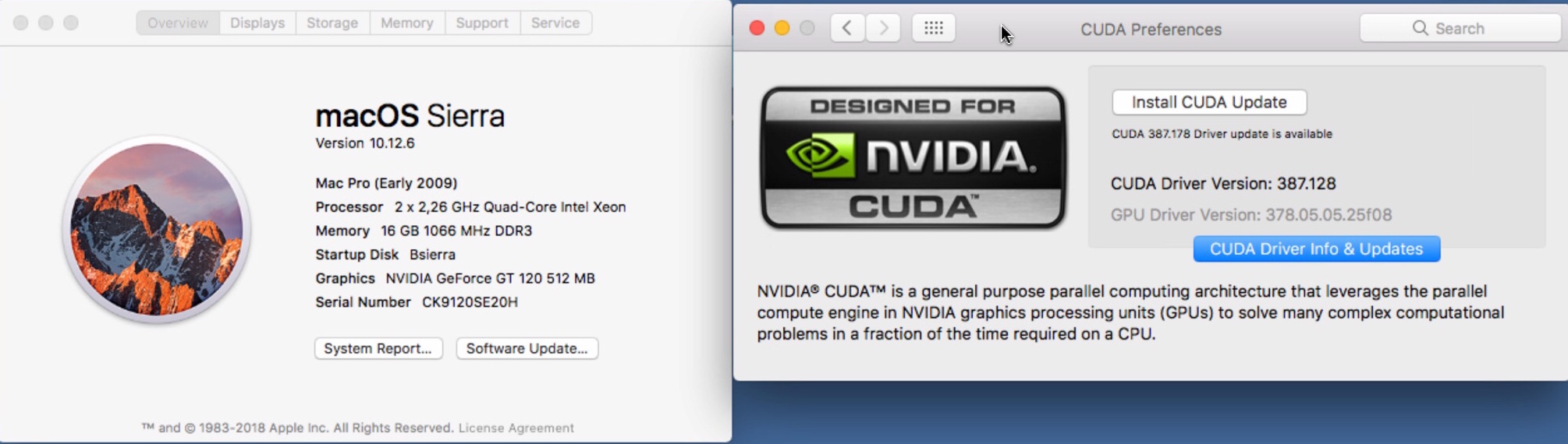

bepeg4d wrote:Hi,
which version of OsX, CUDA, and GPU drivers have you currently installed?
ciao Beppe
MacOS Sierra
10.12.6 (16G1314)
NVIDIA Web Driver: 378.05.05.25f08
Thanks.

adeelk93
Posts: 21
Joined: Sat Oct 03, 2015 12:14 pm
Exactly the same as yours.
