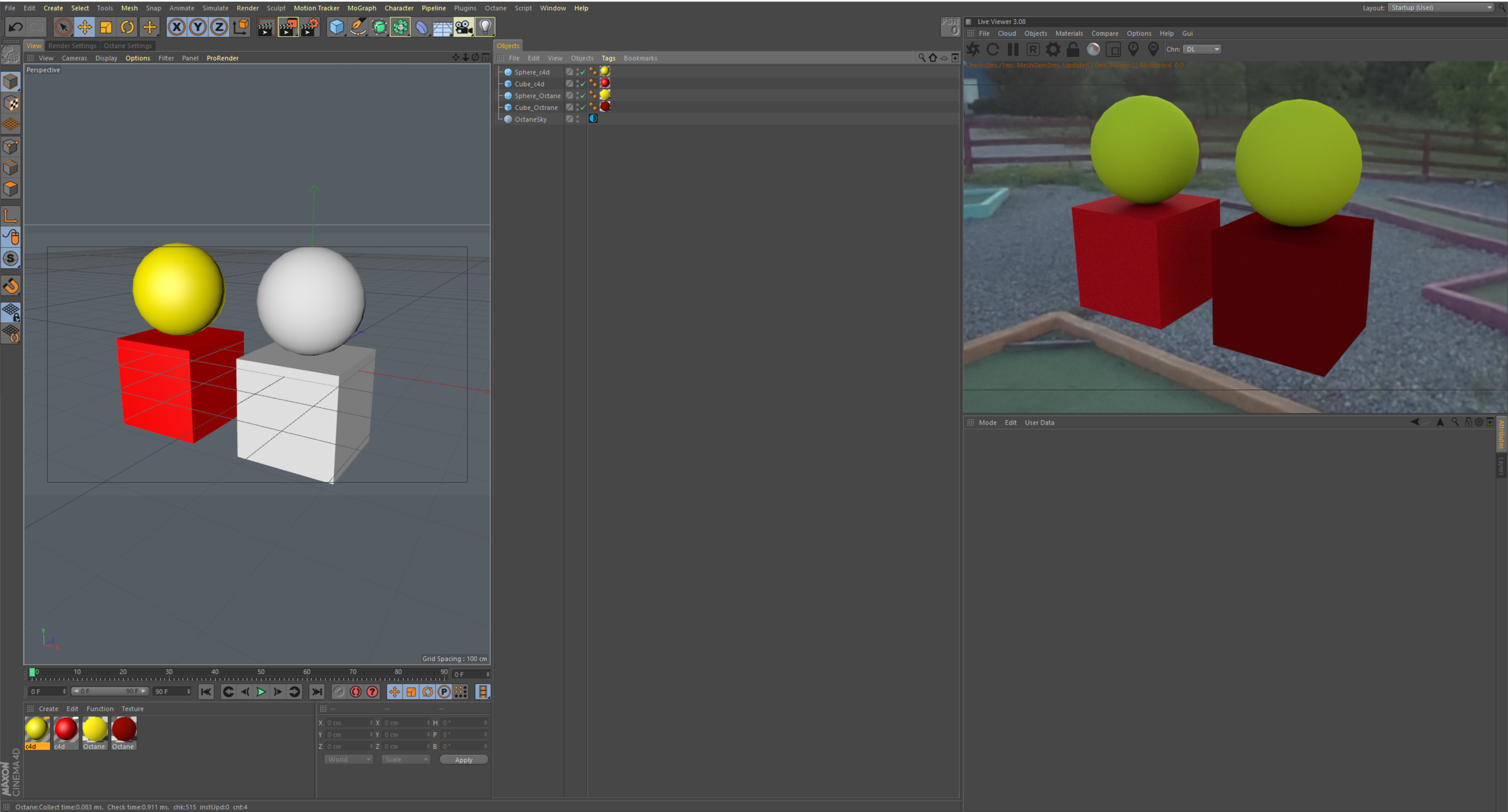

Hey guys, having a weird issue and I havn't been able to find much to help me out. It's probably got a pretty straightforward solution.
My materials all render correctly in the live viewer but for some reason in the c4d view window they always turn out white. No matter what type of material it is. I know that it's not a c4d issue because the c4d materials render correctly (see screenshot)

What about LiveViewer/Options/MaterialPreviews parameter?

I have that parameter checked but it does not solve the issue.

aoktar wrote:What about LiveViewer/Options/MaterialPreviews parameter?
Apologies, I checked and unchecked that parameter then restarted cinema and the issue was solved. Thank you very much!
