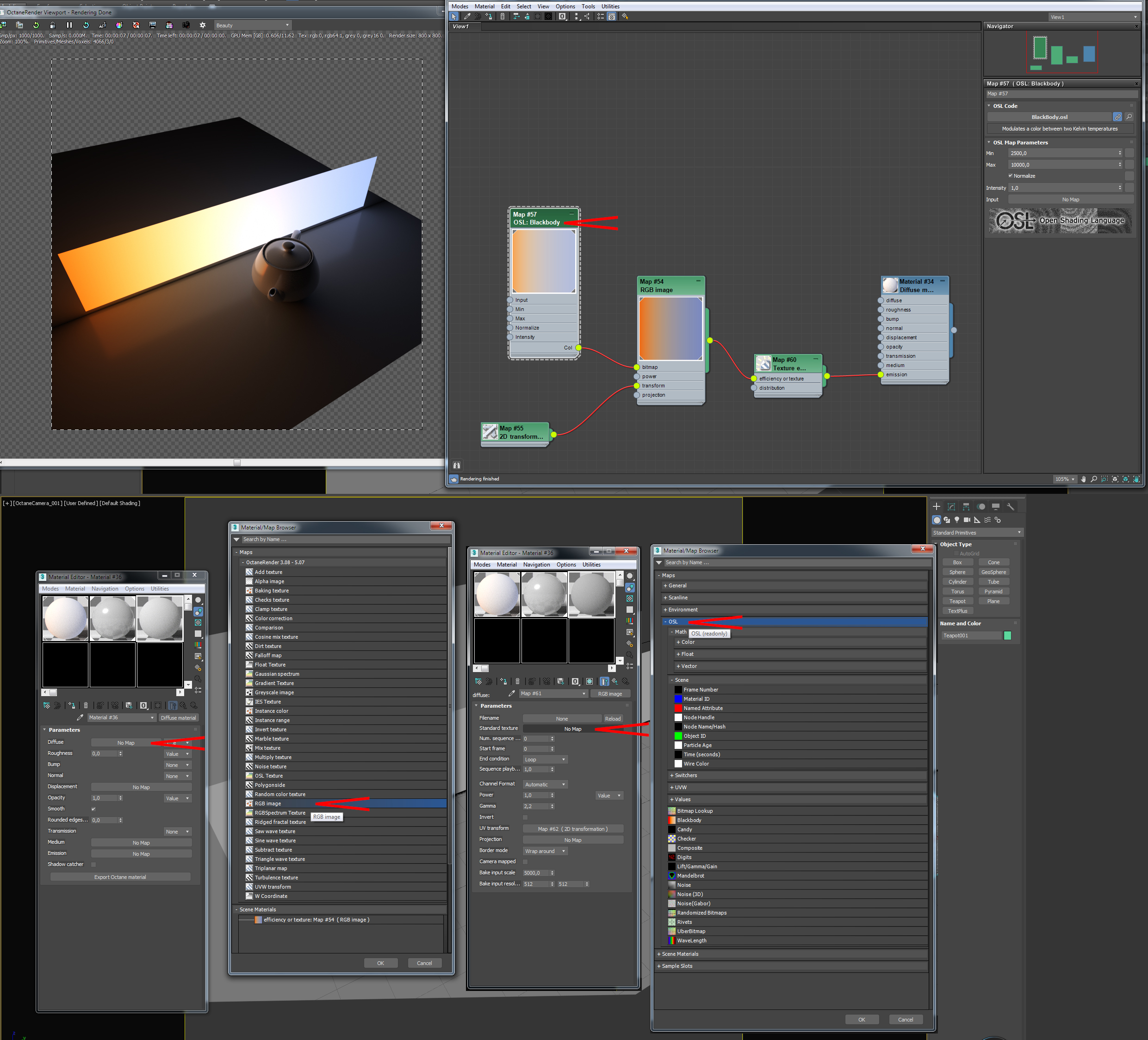

OSLs available in 3dsMax 2019 seem to work with Octane, using 3dsMax OSL node instead of Octane OSL node.
.OSL into Octane RGB texture node > texture standard > 3ds MAx OSL node > .OSL
Regards
Paride
3dsMax 2019 OSL node

Any idea how to use this OSLs in 3ds max 2017-2018?
- paride4331
- Posts: 4004
Hi romones163,
I thought this possibility too.
Unfortunately there is no way; you can try using Octane OSL node but do not always work properly.
Regards
Paride
Regards
Paride
