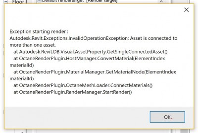

Has anyone come across the following error?
If i create a new scene an just do a simple set of walls, everything is fine. If it try any of my more complete projects this pops up.
Cheers Pie
I thought this had been fixed in the latest STABLE build (3.7.0.51). Are you running that version of the plugin?

Hi Paul,
Im 100% running the latest version of both octane and the revit plugin

Can you pls send me the revit file which produces this error, and I will take a closer look.

Done, sent you 2 different projects with the same problem. Let me know if you need anything else

Hi, thanks for sending through the files.
This issue is fixed in the next release of the plugin, which I will post to these forums a day or two after Octane 3.08 RC3 is released (which is imminent).

Hi Paul,
I am also getting this error, this strangely wasn't occurring a day ago, but since the model has been developed more, it now occurs and doesn't let me continue.
I have downloaded the updated to 3.8.0.5.2 version but it still occurs.
Happy to send you the file if necessary.
Edit:
This was with Revit 2018. I upgraded the project to Revit 2019 and the error no longer occurs.

My apologies Chris - the 3.08.0.52 installer was mis-named as being for Revit 2018, but it was actually for Revit 2019, which I think explains why this issue is resolved for you.
