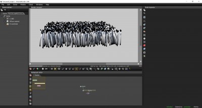

I'm having troubles exporting hair&fur from 3ds Max 2018 to Octane 3.08 Standalone.
I converted the hair to splines and then exported to .ABC Ogawa but then when I import the file in Octane I get these strange shapes on each sides of the strains.
Moreover, I have no control on hair thickness : they stay the same no matter what number I put in the Octane import settings.
Does anyone know by any chance how I could get this right ? I attached an image showing the issue.

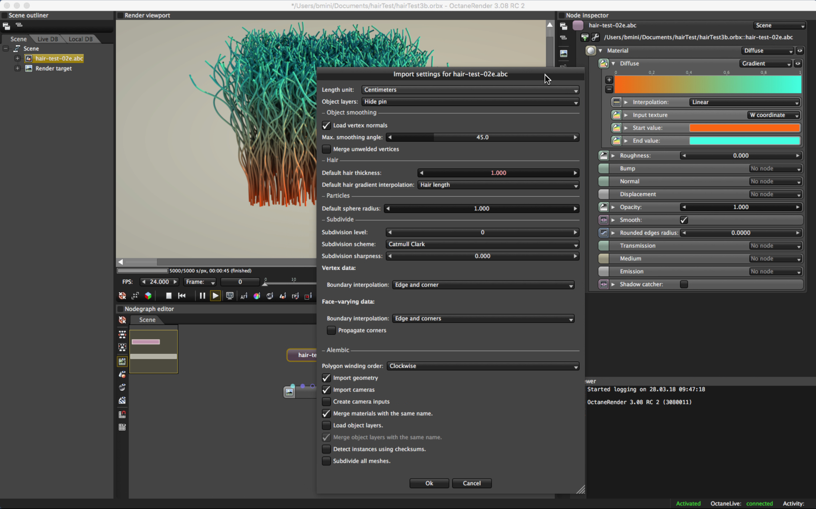

About the thickness, after importing the .abc node, press the tool icon in the node inspector to change the thickness of your splines: Note that from 3.07 you need to use the thicknees value at the same scale used to import the splines.

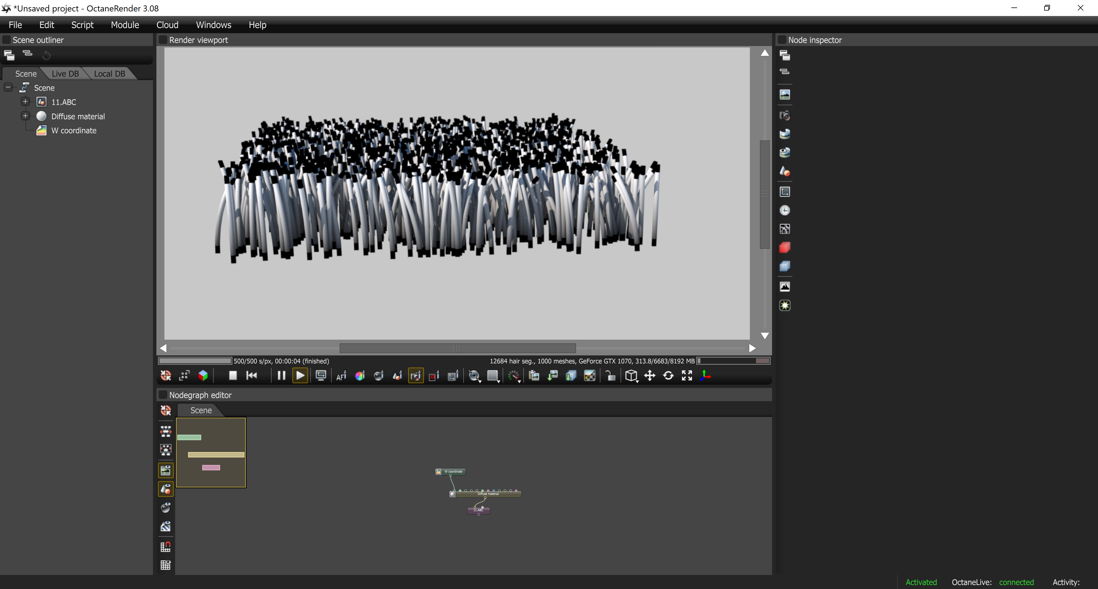

Thanks Beppe, this is weird indeed.
About Default hair thickness, no matter what value I enter (I tried 1, 0.1, 0.01 etc.) in the settings, it remains the same in the viewport.
A potential lead to understanding what's going on : after searching the forums a bit more, I downloaded the .abc file you linked in this topic viewtopic.php?f=9&t=41212&p=195839&hili ... ic#p195839 and everything works fine. The information below the viewport states 54492 hair segments and 1 mesh, while for my .abc file exported from 3ds Max it states 12684 hair segments for 1000 meshes. I only exported splines, so isn't it strange that I also have meshes (1 per hair btw) ?
