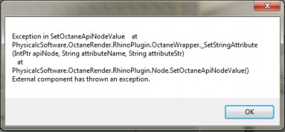

some times i have this error.
It seems that scene has too many polygons. Is it possible?
bye
face_off
Posts: 15822
Location: Adelaide, Australia
What is your Settings->Max Number of Polygons set to? And how much CPU RAM do you have pls?
Paul
fabrizio_s
Posts: 345
Joined: Fri Feb 03, 2017 12:14 pm
Hi Paul,
I have 32 Gb of ram and a graphic card with 11 Gb. My max number of polygon is 8000000. If I increase to 80000000 sometimes I have another error. So..which is the correct number?
Bye
face_off
Posts: 15822
You have given 2 difference Max Polygon numbers - which one is correct pls?
Paul
fabrizio_s
Posts: 345
Hi Paul,
with this error the number is 8000000 but as I said if I increase this number to 80000000 sometimes I have another type of error.
Now I'm trying with 30000000 and for now, everything seems to work fine.
bye
face_off
Posts: 15822
Hi Fabrizio
8 million Polygons will certainly be too low. I think the default set by the plugin is 10 million. The plugin actually caps the maximum value at 80 million, but I think you would need 64GB of CPU RAM to handle that amount. So 30 to 40 million would be the best value if you have 32GB of RAM.
Paul
fabrizio_s
Posts: 345
Thank you very much Paul for your explanation
