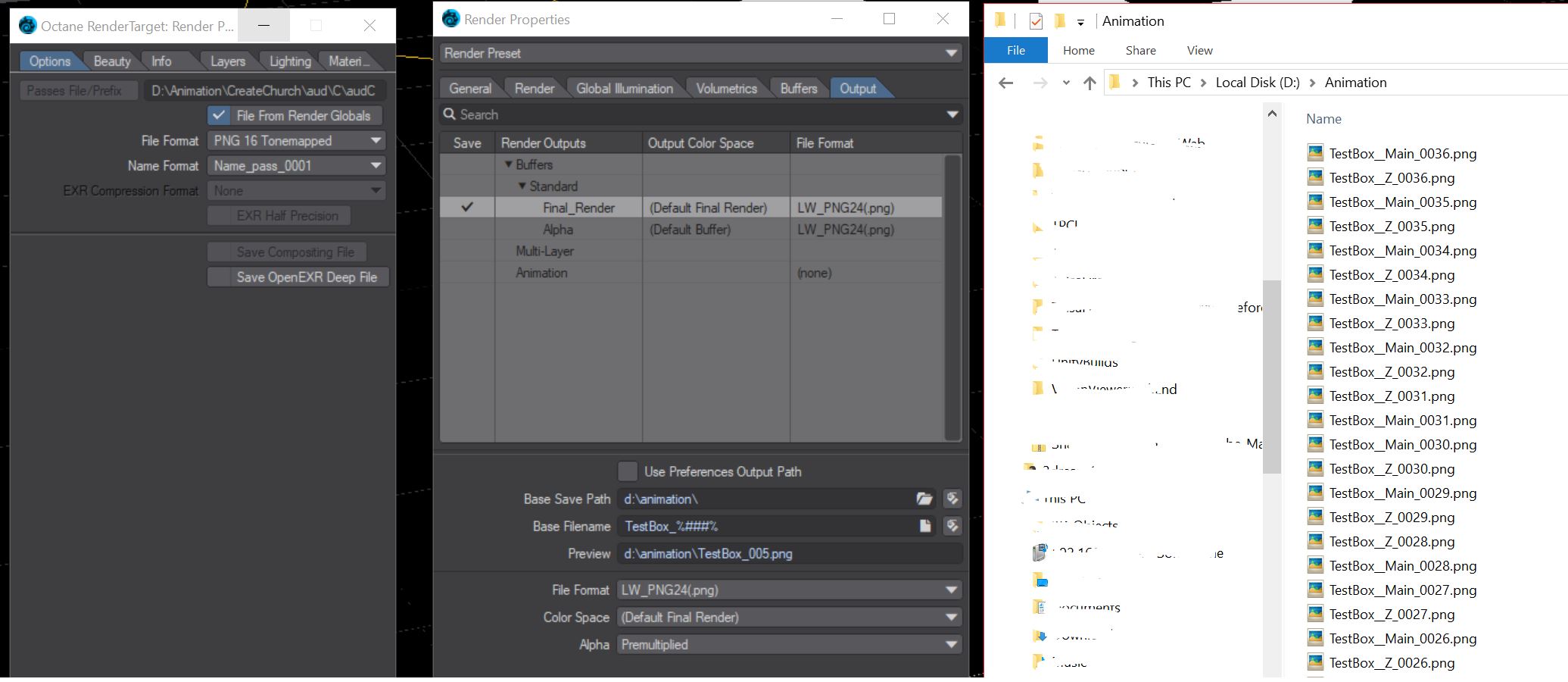

Let me explain, if we now HAVE to use the Render Pass node in Octane to get anything from LW to save in 2018, then how do we make the NAMES that a render manager is looking for after saving to check that everything is ok, to match?
In Octane all we get is some pre-defined Name_pass_0001 options. In 2018 we get these variables to setup however we want. The trouble comes in when Octane is adding "Main" to the image format name and Lightwave's "Buffer" variable is not the same.
All this and we now have to make sure that in TWO places everything is JUST RIGHT so our renders will SAVE and be verified by render manager! Otherwise render manager thinks hey I sent that file to be rendered NODE said it was done...but I'm looking for it and it's not there..I guess I render it again...and we never get to our next scene!!!!!
There has to be a better solution, I really wanted to move to 2018 from 11.6.3. Please let me know what I'm missing or how this can be better.
Example image is attached below. In a perfect world if there are limitations with the new SDK it would be best to have to "configure" in one place what we want output. But at min, if we have to set them up the same, we will need some more options I guess. So if the PLUGIN incorporated a VARIABLE system like the new LW we could at min, match the naming convention.

I have a very crude work around working.
We setup a naming convention in LW Native saver.
Tell Octane to use render path from globals.
Make sure name format and file format are same in Octane.
Once pulled into Render Manager, we add the _Main to what it's looking for on save.
If any of this is missed or not done properly the entire weekend of rendering or whatever is bust!
SOOOOO much more trouble than before... I'm hoping there is an easy fix by someone.

Ok. I'm not sure if I'm going to be able to fix the LWSN issue from the plugin side ... it seems a LightWave limitation. Have you reported this problem to the LW team? If not, I can open a bug report for this issue myself.
So, from the plugin side and while saving the images with the passes node, is your problem with the render manager that the beauty pass is saved with the "_Main" suffix in the filename? Removing this suffix (adding an option to the render passes node) should be fairly easy.

As for the naming, it would be great and probably welcome by others to include a similar setup as LW native does with the variable names. Of course the variable names would need to be the same as LW where they can be, and save out the corresponding same name as LW does. As you mention...Main vs Final..etc.
Thanks for your attention to this!
