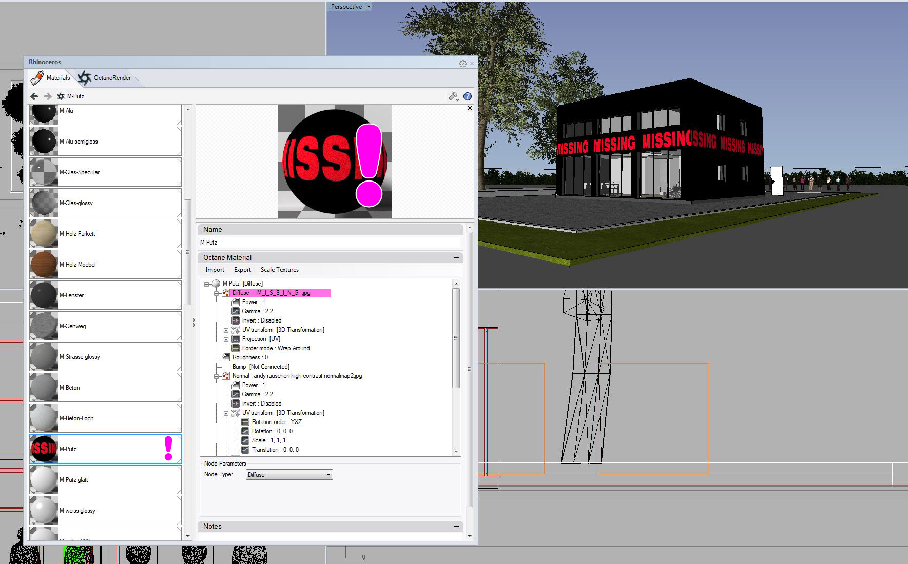

Would having the current missing textures popup also display the material that the text belongs to help? I could change the buttons too to add an "Ignore and Continue Searching" option.
yes, this would be a good thing for sure, please implement it. Another small thing my colleague just told me: could you also implement an option to auto confirm all relink reports, so there is no need to "accompany" the process for several minutes. Something like a "auto confirm all relinks" button.
Loading a new file will be a problem, because that file may be used in other materials.
I am not quite sure if I understand this... in case the file (a texture...) would be used by other materials (in the scene ) these materials would also be affected by the texture missing right ? So assigning another texture as a replacement would also "heal" these materials too... or am I missing something?
In case you enable the "Ignore and Continue Searching" option, could the exclamation mark sign on material previews and texture nodes be implemented, in case the user decides to "ignore" the texture?
It might also be a interesting idea if, in case a texture is missing, octane would assign a black texture with a red "MISSING" to mark these missing textures while rendering...
attached please find a few pics illustrating the above...

I think I can implement some of your suggestions - however ultimately it's an asset management issue that you need to fix outside Rhino.
Paul
This is a complex change, and I don't think the benefit justifies the implementation effort.
