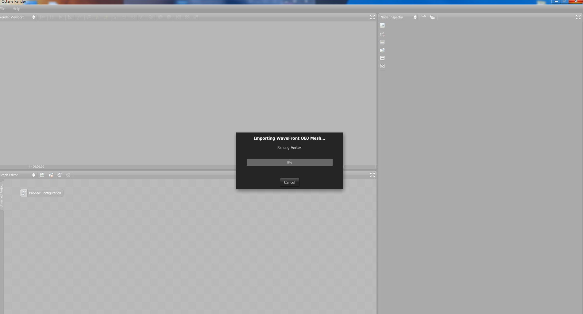

At firs, sorry for my english, it's terrible..... i want 2 buy octane, but first i want to learn it with demo version, aaaand.....i can't use it, i don't know what's the matter, but when i load my scene in octane, this crash...
OS windiws 7 64bit, i've download drivers 3.0 for my NVIDIA GeForce GT240, i've disable sli, use c4d with riptide pro (demo), export obj, open octane, right click,add, object, mesh, load my scene saved in tex folder of my originalc4d'scene, and after some minutes of load....(view the attachement) CRASH...someone can help me 2 understand?
i work with vray but i like octane so much...pleeeeaseee...
hem... sorry again 4 my english, i hope u can understand me....

I've got the same issue before buying Octane, for me the solution was to use the simple Riptide plug-in not the Pro version, you have to start cinema 4d in 32bit mode :(
anyway when you got the license you can download the Octane to Cinema 4D plug-in for a more comfortable workflow and forgot the riptide plugin ;)

We, ciao Beppe,quindi basta aprire c4d a 32b o meglio ancora spendere i 99 euro del software...right?
Posts: 10652
Esatto, in oltre con il plugin torni ad usare cinema a 64bit, mantieni la camera, lanci animazioni e altro ancora ;)
Vai tranquillo i soldi della licenza sono spesi bene ;)
