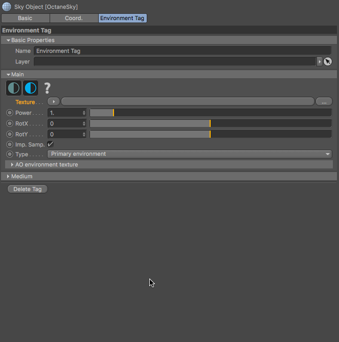

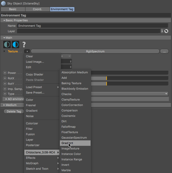

I am having a problem with the Sky Object in 3.08-RC4 (I haven't tested this in previous versions/RCs). The problem is that when I add an Octane Texture Environment and look at the Environment Tag the Texture is assigned as an RgbSpectrum. When I try to change this to a Gradient, the control breaks and I cannot control the Gradient or reassign to RgbSpectrum or any other Texture type. This is not a problem when you first create the Sky Object, only when you deselect/reselect the Sky Object in the Object Manager.
