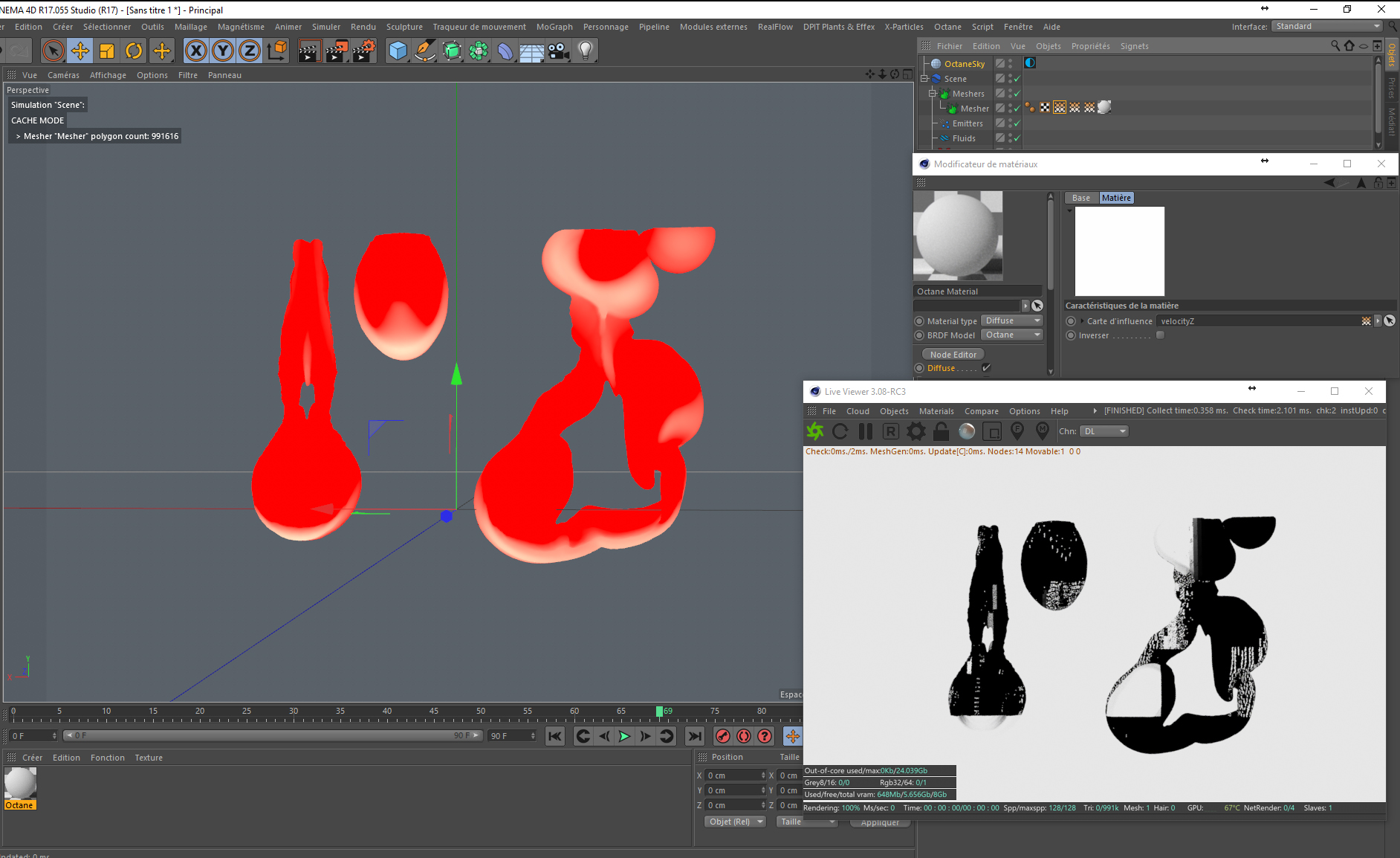

Hi all
I have a problem with wertex map Realflow too.
Windows 10
Version 3.08-RC3
c4d R17
last GPU driver
RF C4D 2.5
offrench
