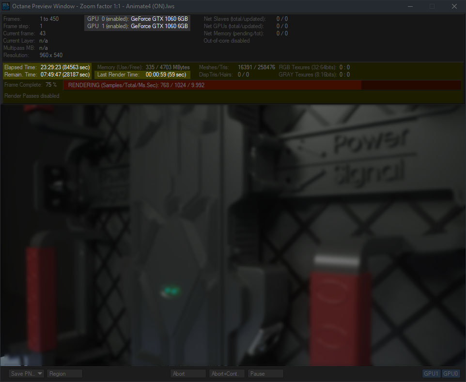

We recently purchased a few GPU's for my render station. It works great for IPR but after my second attempt to render a long sequence of frames it get's hung up after about 20 minutes or so. I even did a complete system refresh with the two new cards present at install.
See screenshot, it was rendering each frame at about a minute each, then suddenly it sky-rockets and actually stuck at frame 43 for over twenty hours.

What a weird issue. I had not seen a problem like that before. Can you please enable the log file in the plugin options panel and attach it here to see if it has any clue about this problem? One thing that comes to my mind is running out of GPU memory, but in the screenshot, it seems that for this frame resolution, the free VRAM should be enough. Perhaps you could enable the out of core feature to see if it helps.
