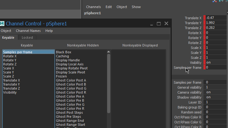

@JimStar,
The samples per frame attribute for Transform node must be non-keyable or hidden non-keyable in the channel box by default,
"non keyable" in Maya doesn't mean an attribute is really not keyable,
it just means that the attribute won't be keyed each time the user key the object (S key or autokey) but the attribute is still keyable in attribute editor and in the channel box (context menu).
On the contrary if the attribute is "keyable" by default in the channel box, it will be keyed each time any transform will be keyed,
adding many useless keys and curves, so will clutter Graph editor for nothing, and on top of that this will trigger a bug with animation layers (as it already happen last time you tried to let a transform "keyable" attribute in channel editor.)
viewtopic.php?f=110&t=56652&p=290751&hi ... er#p290751
