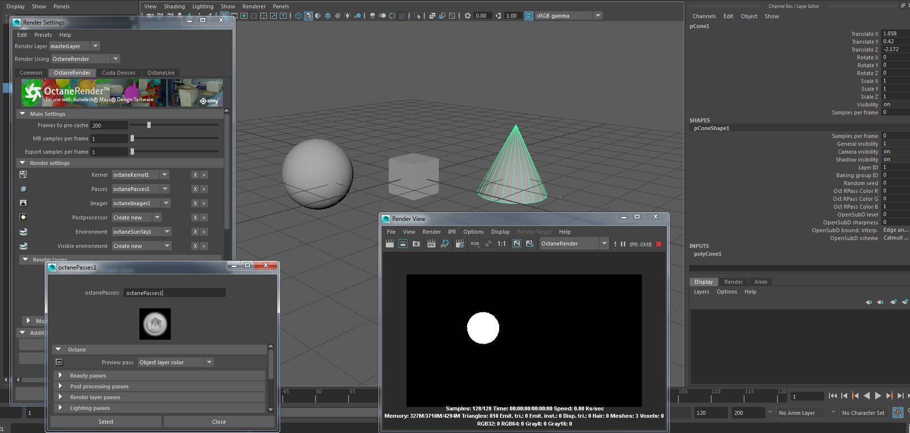

ciboulot wrote: RGB MASK:
- Still no solution to render a simple RGB mask with motion blur, with RGB values set to 1,0,0 or 0,1,0 or 0,0,1. Plain and simple. Just as in this link: https://www.facebook.com/38689510140878 ... =3&theater
- THe "Oct Rpass Color" attribute doesn't work.
The Layer pass color attribute works, these colors are used in the layer object pass.
RGBmaskOjectLayer.7z
(8.09 KiB) Downloaded 297 times
NB : It was also working in previous version, but there was a bug/optimization making that octane attributes where not exported in every case,
the trick was to set baking group ID to 1 to force the export.
Now the layer pass color seems to be always exported without the trick.
Pascal ANDRE

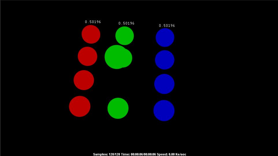

ciboulot wrote: - If we try to get a proper mask via the layer ID 1,2,4, the RenderLayer ID give us a mask with this RGB values:
0.50196, 0, 0 or 0, 0.50196, 0 or 0, 0, 0.50196.... This values are useless for compositing, as we have to clamp or overexpose to get a proper value of 1 in each RGB value.
to get pure R G B in the render layer ID pass you need to use ID 73, 18 and 36.
Not 1,2 and 4 as i suggested in an old thread :oops:
73 = Red
18 = Green
36 = Blue
Pascal ANDRE

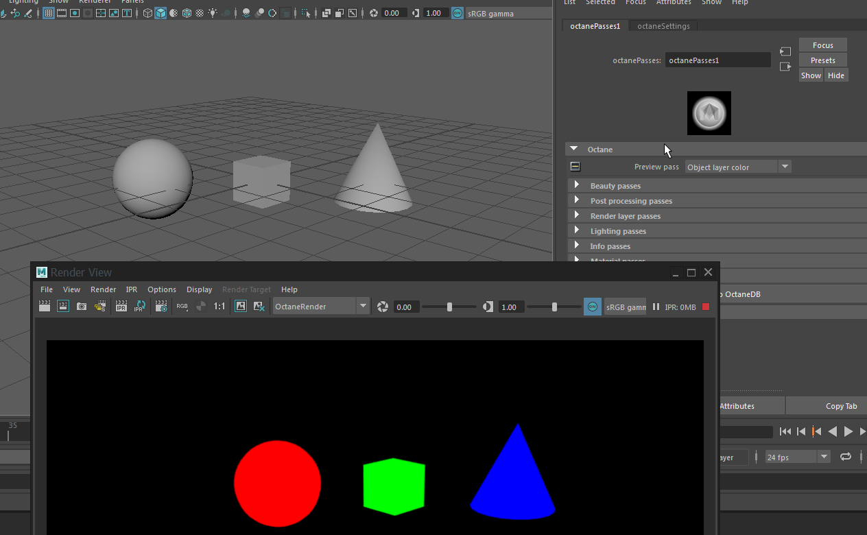

Thank you for your reply but your scene with RGB mask in Oct RP&ass attribut gives that in octane 3.8RC2 and RC1 :

ciboulot wrote:Hi Calus.
Oh right, this works in Maya 2018 but it's completely broken in Maya 2016.
Hum if we have different Octane bug by Maya version, it's not going to be easy to test...
