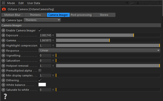

Hey guys,
I've been looking for a solution on Google and in the forum for a few hours now and can't solve the problem.
When I render the image into the Picture Viewer and export it manually everything is correct and it looks like in the Live Viewer.
But if I export the image directly via Octane, something is wrong with my Color space.
I don't have the problem like some people that the pictures differ in the picture and in the live viewer.
It differs only when exporting.
I changed several things and also different render buffer types but unfortunately without success.
I'm pretty sure it's just a little mistake I'm missing!
I also added some pictures that might help to solve the problem.
Thanks in advance!
Jens
