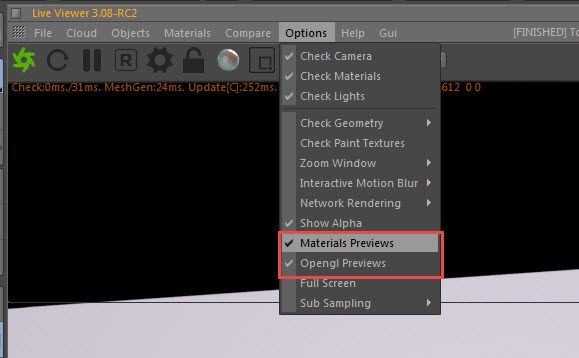

In my scene i have many animated octane materials, so they update every frame, and this makes the scene very slow to work with.
can i make them NOT updating in the materials window?
thanks!
Posts: 16066
Location: Türkiye
try to change this options
turtles123
Posts: 85
Joined: Tue Feb 18, 2014 4:06 pm
BOOOOM! done! thank you very much!
