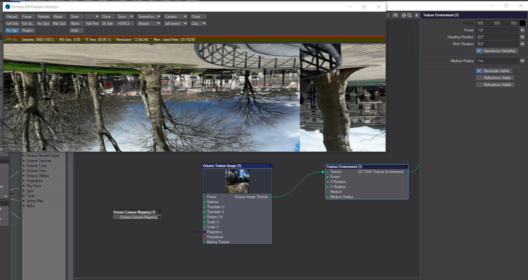

Backplate is not working fine to me, I get a displaced and flipped image.
I'm doing something wrong?
Regards

Asticles wrote:Hi,
Regards
I'm not sure if the camera projection can be used with the texture environment. Was it working before, in previous Octane versions? If you need to add a background plate, you can use the native LightWave compositing feature.
