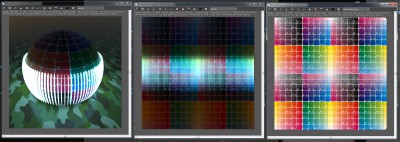

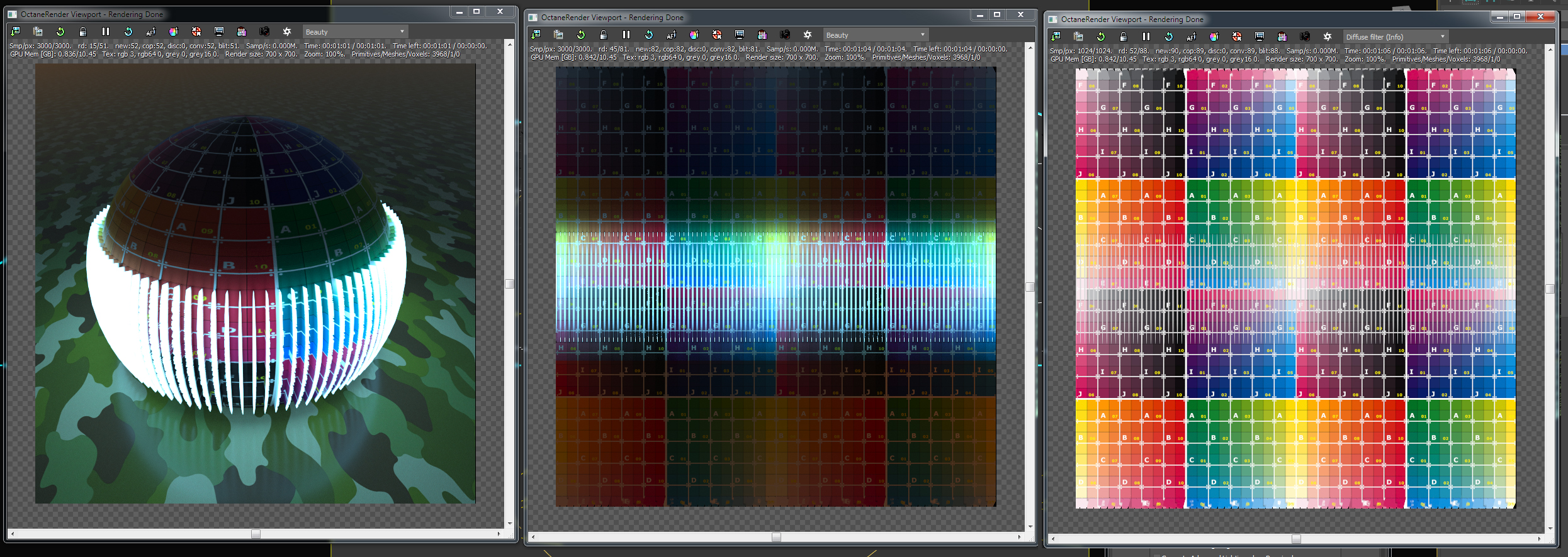

I have a question that I can't quite work out myself and wanted to see if anyone here had any input. I have a mesh in my scene that I am doing texture baking on to generate some unwrapped image sequences. This mesh has properly layed out UVs and looks correct in the render. However, I have a second mesh which is essentially an animated set of thin lines which "scan" over the surface. These lines are basically just extruded wires which are clamped to the surface, and set up with an emissive material. My problem is that when I bake, I can only see the light those meshes are casting onto the surface of my UVd mesh (obvious behavior, as it is the object with the baking ID currently being rendered), however what I would like to do is essentially trace the scene using this same baked layout, without excluding objects that rest in front of the UVd mesh. Is there any way to accomplish this?

you should use diffuse filter material pass; in Octane 3dsMax is "diffuse filter (info)".

Wow this looks like exactly what I want, just to confirm, this method works even if the emissive mesh is separate from the mesh being baked? I am having some issues seeing the lines within the baked render (in diffuse filter or the regular baked view).

I think your issue depends on unwrap not being diffuse filter, or you should assign the same Baking group ID.
