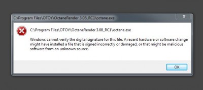

Hmm, I don't know what is this issue with the digital signature in the Standalone, I had not seen it before, but perhaps the problem with the plugin is that somehow the system doesn't want to load it due to the same issue.
Can you please try to download the just-released 3.08 RC2 standalone to see if you have the same problem? Really we need to know if the Standalone works fine on your system before trying to find the problem with the plugin.

Thank you for your support!
I installed RC2 but I get the same signature issue.
I booted my windows with disabled driver signature enforcement and both standalone and Houdini plugin work just fine.
Not sure why my system cannot identify the signature. If I check octane.exe file, the digital signature is OK.
Also 3.06 with Houdini 15.5 worked fine few months back (if this is any helpful) and when I run 3.06 standalone now it still works with no issues.

Just adding a final comment here in case someone will come across the same issue: I just needed to run Windows Update and install all updates from the Important list.
Now Octane works fine (both standalone and Houdini plugin) without need to disable digital signatures.
