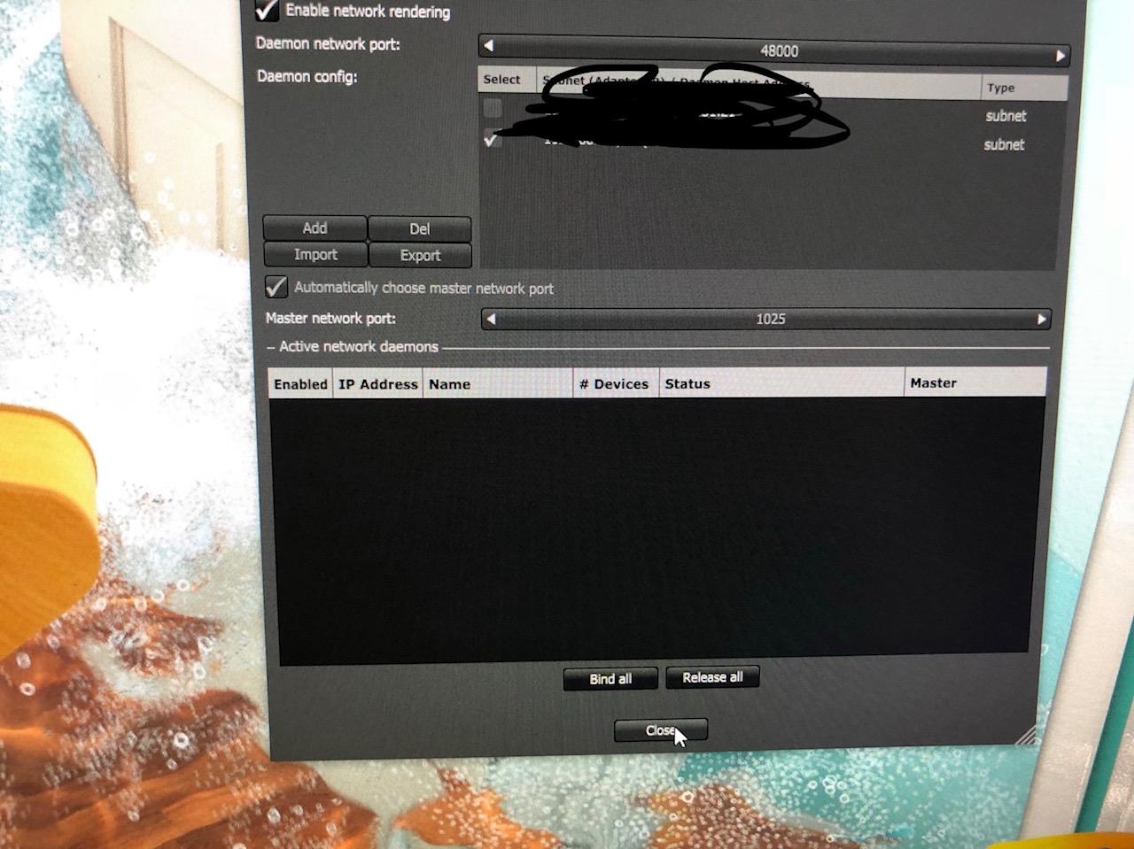

can anyone at otoy at least give me an advice why slaves just disappear after rendering 2-3 hours from network list especially when rendering lots of foam and phoenix. Does my network card fail? Can it be a router? Slaves just disappear and octane continues to render with master GPUs. All slaves have to be manually restarted it's been for 3-4 months now Never had these problems before. Thanks

coilbook wrote:can anyone at otoy at least give me an advice why slaves just disappear after rendering 2-3 hours from network list especially when rendering lots of foam and phoenix. Does my network card fail? Can it be a router? Slaves just disappear and octane continues to render with master GPUs. All slaves have to be manually restarted it's been for 3-4 months now Never had these problems before. Thanks
Please try binding your machines MAC addresses to certain IPs on your router settings (usually it is 192.168.1.1 or 100). It may happen that your IPs are assigned randomly. Let me know if it helps.
