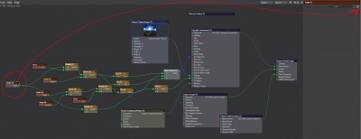

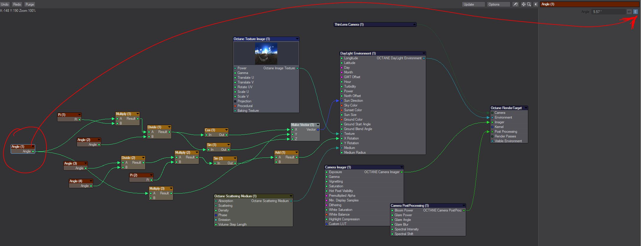

When changing the value inside this node using graph editor the changes aren't reflected in IPR, if not using E(nvelope) button (using single value) changes reflect in IPR.
