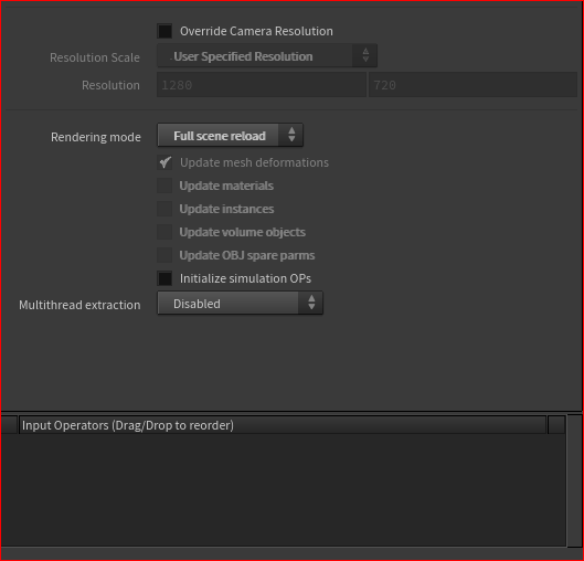

It looks that we must force with a full scene reload when rendering liquids ?
intuitively i might have think mesh deformation would be good enough.

Hi, yes, usually while rendering fluids you are going to need to use the full scene reload because the object topology is not constant between the frames, so a full object reload is needed. Updating the mesh only makes sense for objects with deformations that have a constant topology, because if not, in any case, the object must be fully extracted.
The objects extraction/update is usually fast, but Octane spends some time preprocessing the scene to build the final GPU data and pass it to the GPUs. I'm afraid that this time is going to be needed in any case, but if you want to attach here a sample scene with your workflow I could take a look at it and check the extraction/preprocessing times.
