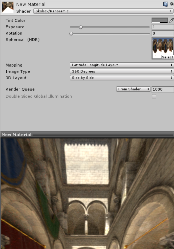

You can save/export the rendered result as a texture via the PBR Viewport. (One of the middle buttons)
In unity - you can reimport that texture as a cube map with latitude-longitude mapping.
Unity 2017.3 and higher have stereo panoramic skybox material that can use Octane stereo panoramic renders. Seems that unity supports both side-by-side and over-under
Here is an example. Havnt tested it in VR yet personally.

Hi Chris,ChrisHekman wrote:You can save/export the rendered result as a texture via the PBR Viewport. (One of the middle buttons)
More here:
https://docs.unity3d.com/2018.1/Documen ... ramic.html

Thanks so am creating a texture and will then try and re-import as a cube map.
