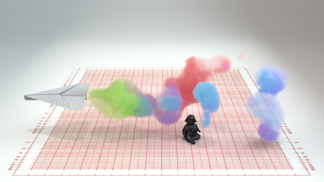

aoktar wrote: V3 SAMPLE SCENES SET(make a request if you need any spesific sample)
https://render.otoy.com/plugindownloads ... scenes.rar
Dear aoktar.
I've been trying repeatedly fore some days now, but I don't manage to acheive what I want..
I am looking for a way to rainbow-color the clouds generated with a Octane Volume Object. Please see the attached image rendered in VRAY to ilustrate what I mean.
Could you generate such a file for the SAMPLE SCENES SET .rar-file?
