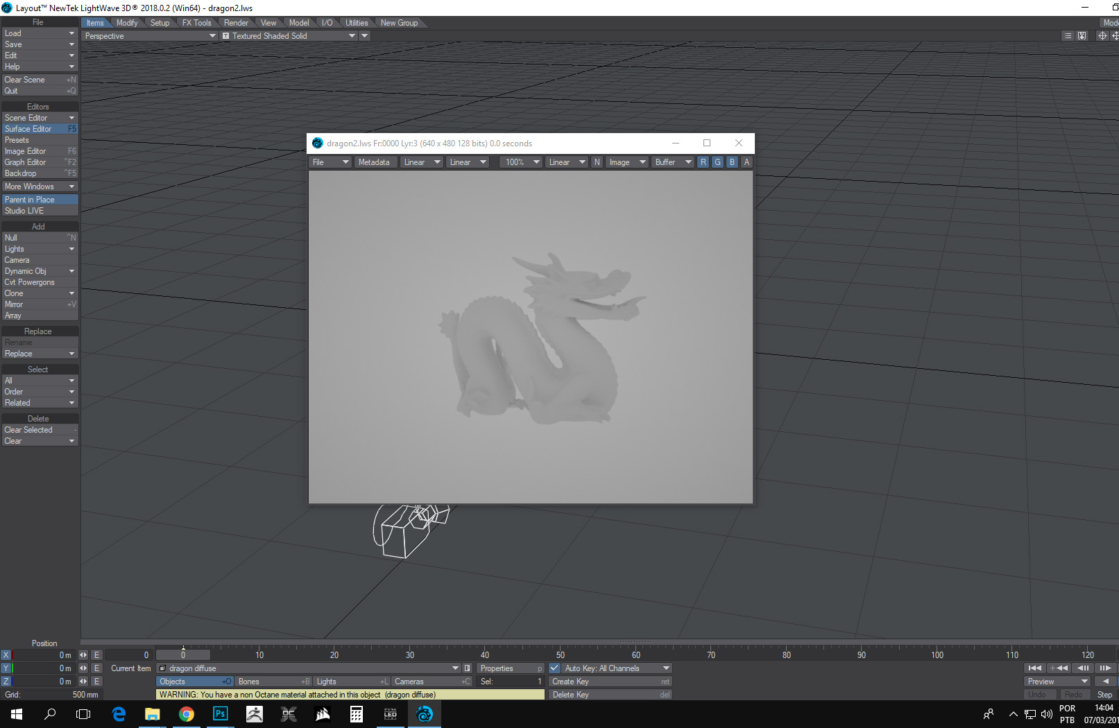

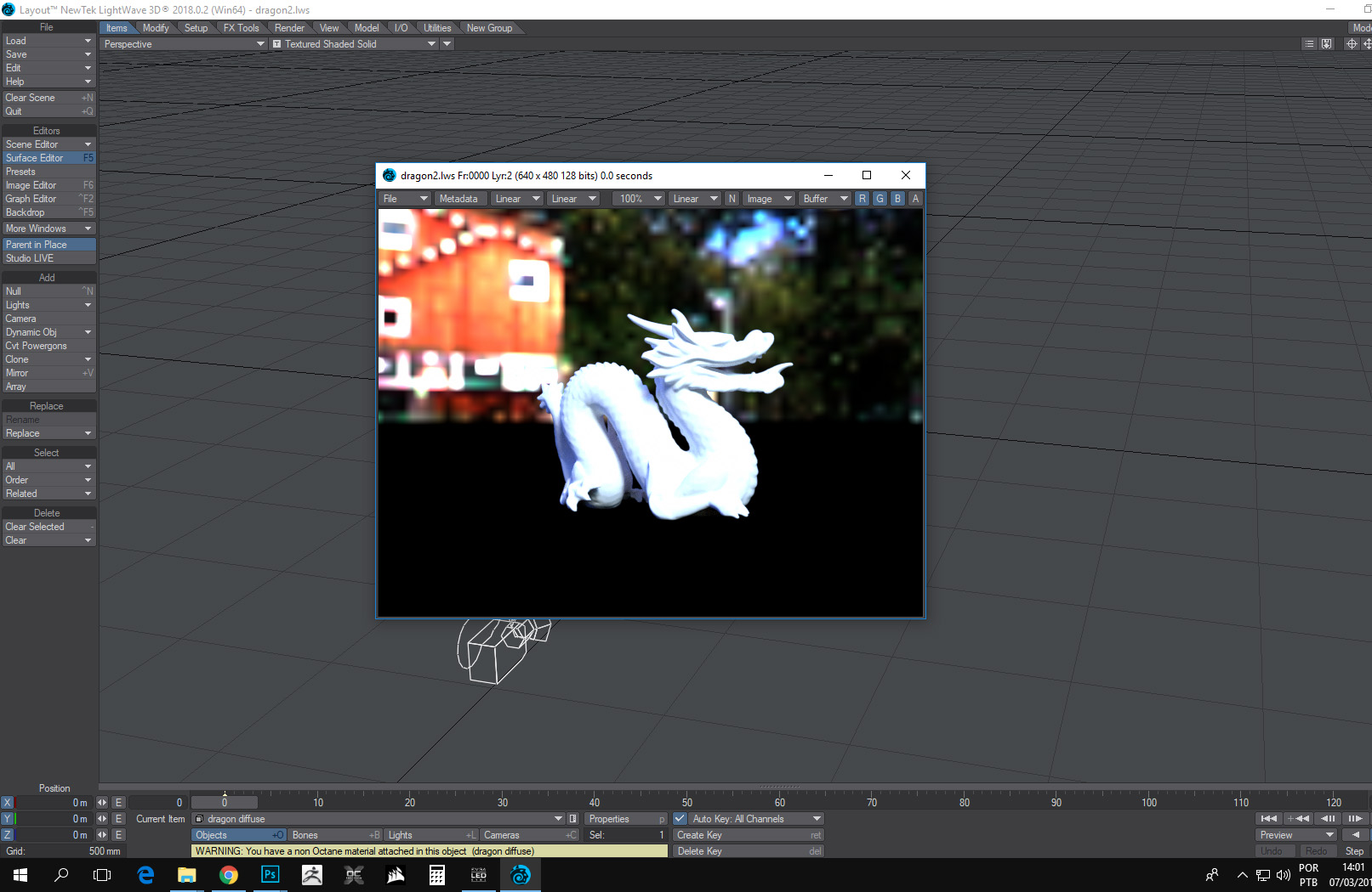

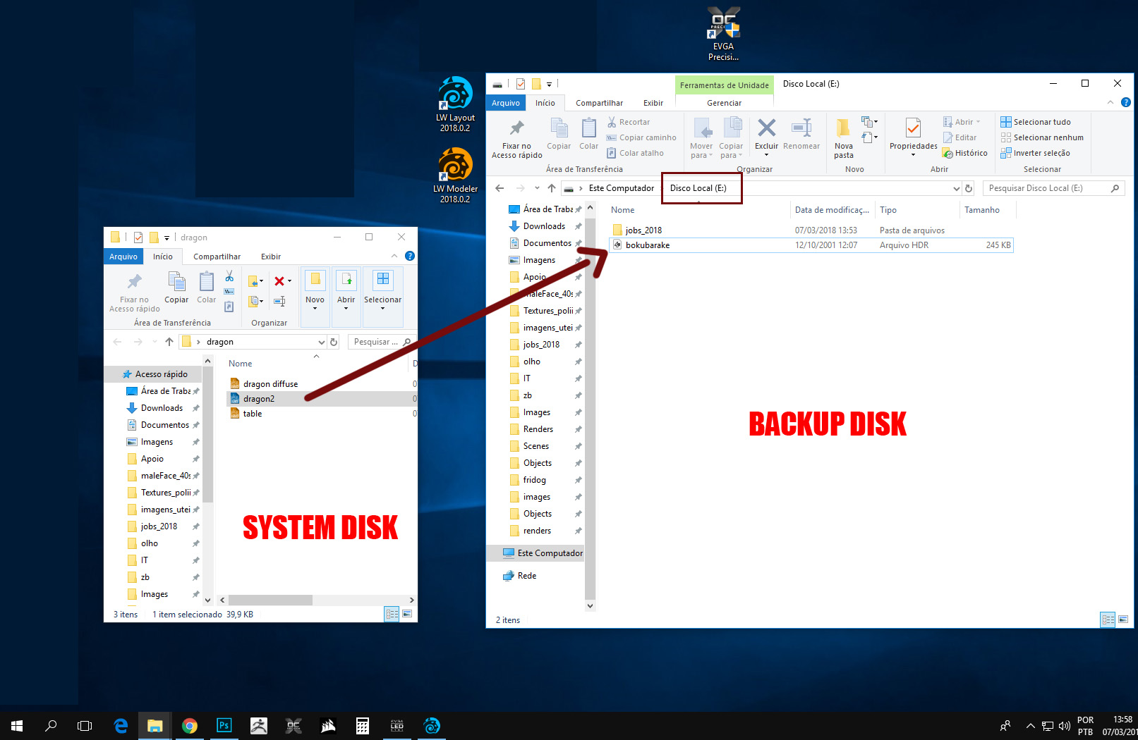

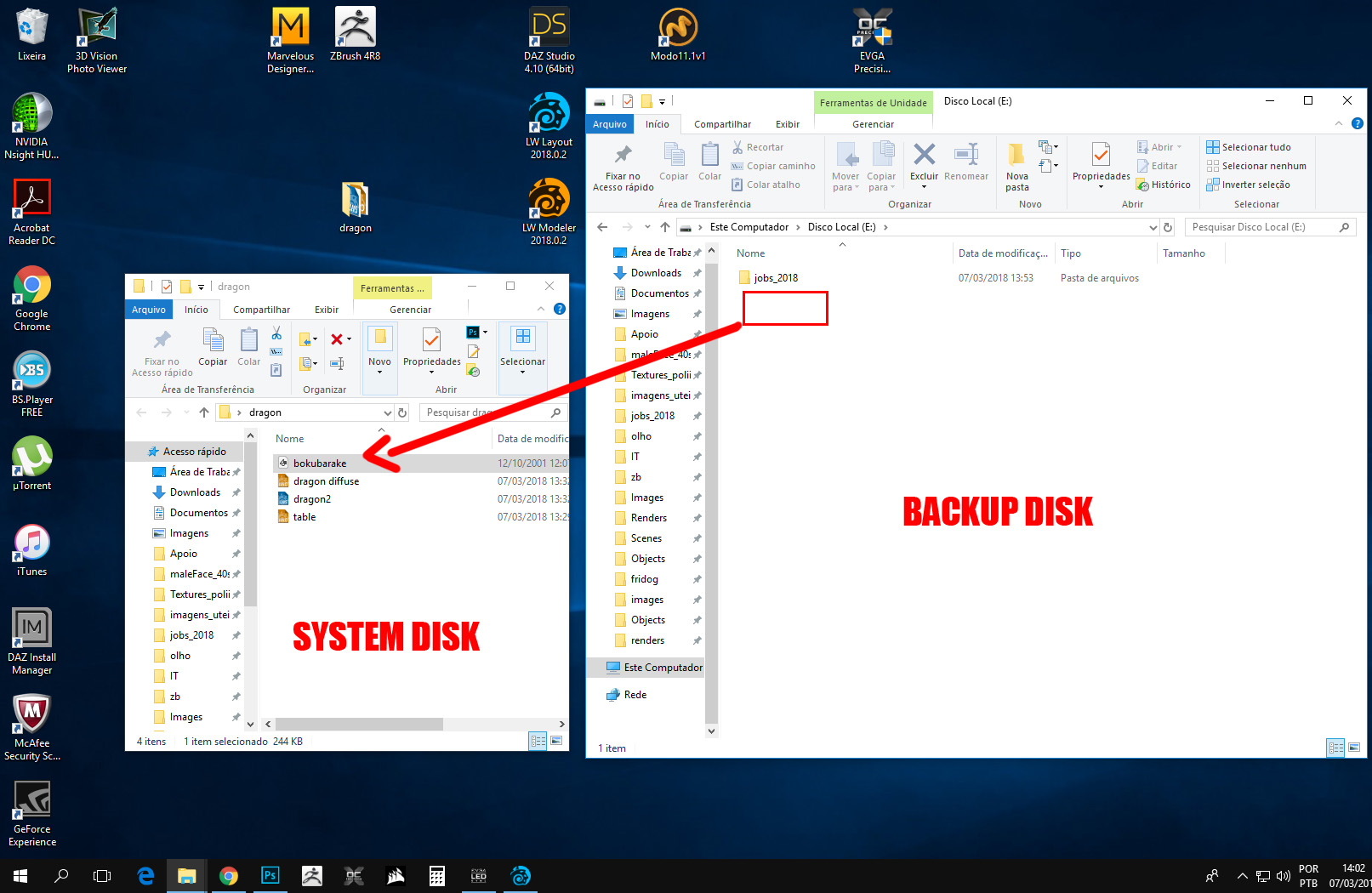

Hi All,
In my computer I have one ssd disk for system, and a second one for backup. In the ssd disk I keep also my HDRs library. I open a scene That I was working, and the Hdr was not loading.
So I tried to replicate the problem. I am using LW 2018 and the last version of octane.
I made some printscreens to demonstrate the problem. If someone is going to test the scene remember to CUT the hdr from system disk to local disk, or vice versa. If you just get the file and move, It will make a copy.
In previous versions, This was not happening.
Thanks,
Saulo

The printscreen sequence correct is upwards.
