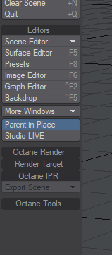

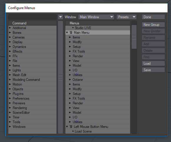

gordonrobb
Posts: 1247
Joined: Sat Mar 16, 2013 9:08 am
Thanks for this.
I'm having some problems though. To be sure I wasn't doing anything stupid, I downlaoded the 2018.0.2 update so that I was starting on a new install.
I downloaded the Plugin.
I made sure I extracted the 2018 version
I coped the files you need to copy and put them in the bin folder (as normal) of the 2018.0.2 install
I added the plug in
I installed the menu tree.
This is where the first thing happened, this duplicated all my existing menues (see image).
Also, when I go to the octane tab, I don't see any of the tools (see image)
Any ideas?

gordonrobb
Posts: 1247
promity wrote:
Any ideas?
- uninstall LW, delete all config's, install lw again.
It happened with my already installed 2018.0.1. So I downloaded and installed a clean 2018.0.2 and it was the same. So this is with a completely clean install.
