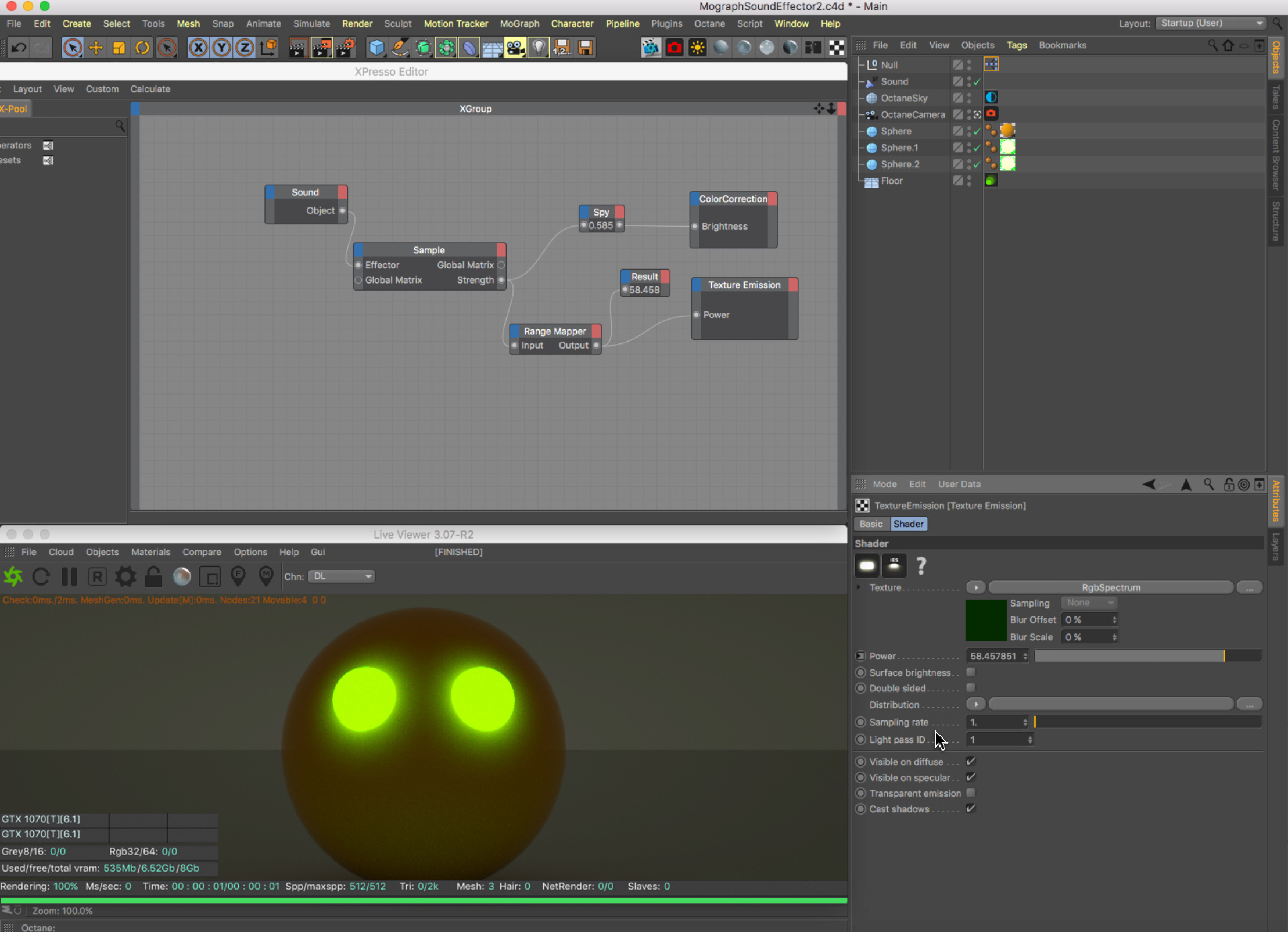

How can I do this with octane lights and sound effector?

You need to use Xpresso, please, have a look at this simple example:
mographsoundeffector2.zip
(667.21 KiB) Downloaded 98 times
ciao beppe

Meanwhile I came to another solution with the mograph color shader
in the distribution channel of the octane light.
thanks!

Hi Beppe,
thats nice, but I looked for something a bit different.
I needed a pattern of lights with random/irregular lights going on and off
with the sound.
Maybe not the best solution, but I ended up with this.
Test_Soundlichter.zip
(84.32 KiB) Downloaded 122 times
thanks again
