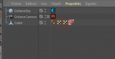

There is a manual workaround. It's more a trick than a solution if you have a lot of maps to render. If you invert order of UV maps tags manually in the object manager, it will works. Unfortunately, this kind of manipulation seems to not be recorded by the takes. It could be usefull in this case.
