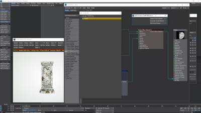

In stand alone Octane, I saved to Local DB. In Lightwave, I don't see it.
Searching on the forum I found the file location on my system and it is in their under the group I created in Stand alone Octane.
Actually to be clear, the group is not listed under the Local DB.
Thank you,

Do you have the LocalDB in the same folder in Standalone and the LW plugin? In the plugin, the LocalDB folder can be set in the plugin options panel, in the Options tab, the first option available.
Thanks,
-Juanjo

Thank you Juanjo that solved the problem :)
