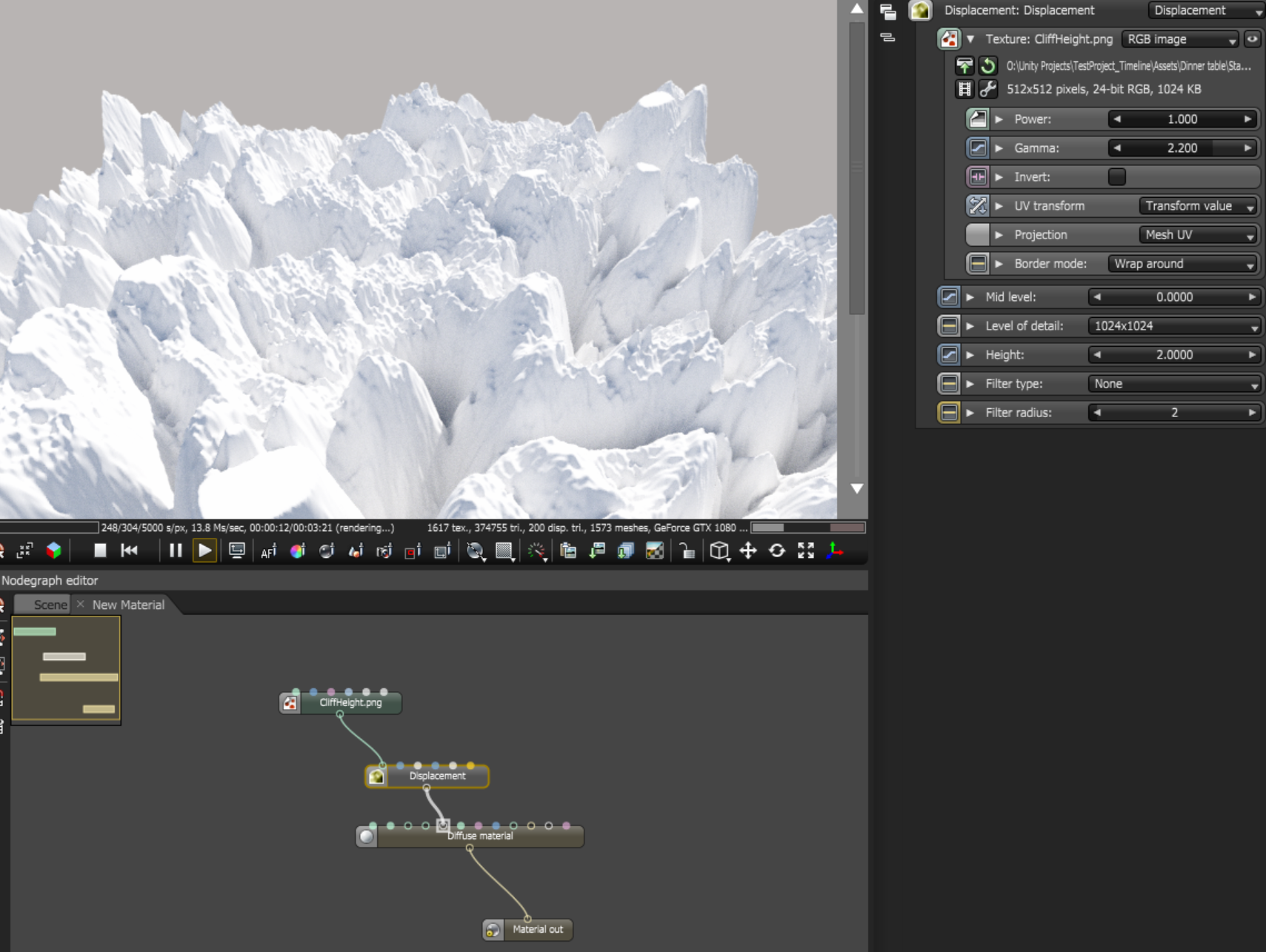

You can render a terrain in unity using unity terrains. That should show in octane. (Trees/grass are comming later)
Otherwise what you can try is the following:
Create a plane in unity.
Create a new material with a PBR Override shader. Click view source
Then create the following nodes (Displacement node, heightmap texture, diffuse material)
