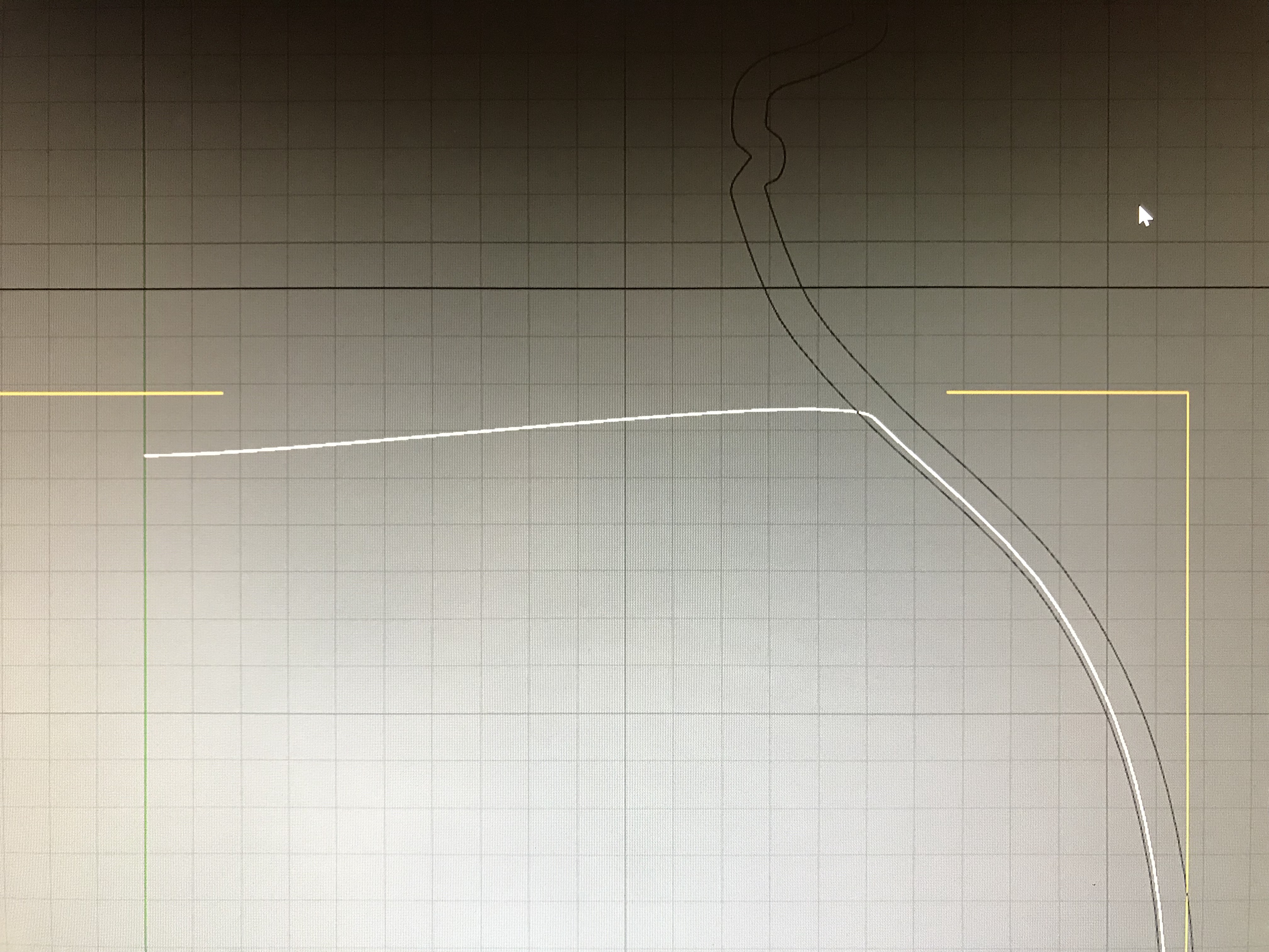

I used to have this issue in C4d natively but found checking and reversing the normals if required - as moose mentions - solves this even when spline modelling. I'm guessing reversing the normals would be the answer regardless of you modelling technique?? Spline modelling is how I model bottles as I am from a retouching background, so I like to use Illustrator or the pen tool in C4d.

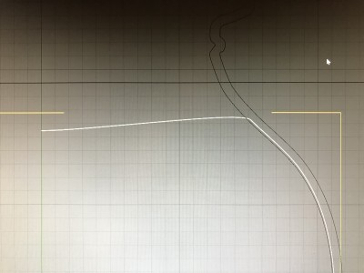

Builtdown mentions the air gap. I went through this with C4d and the physical renderer and the common theme I got here was that that the liquid spline needed to intersect the glass spline (effectively a little bigger) See pic attached. Now I'm not saying this is right or wrong and maybe this technique is the way to go with Lightwave and maybe even Octane.
Also mentioned is IOR, surely the correct IOR should used for different types of glass as well as liquids and we shouldn't have to 'fool' Octane with incorrect IOR's.

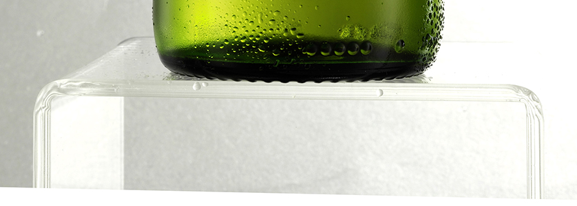

regarding your comment on the reflections seen on the base of a bottle.... in a real photoshoot, much of the time the bottle is shot on some sort of clear stand then the ground reflection is shot separately, then the two are combined in post. This gives you the clean look you're after.
Here's an example of that from one of our photoshoots.
