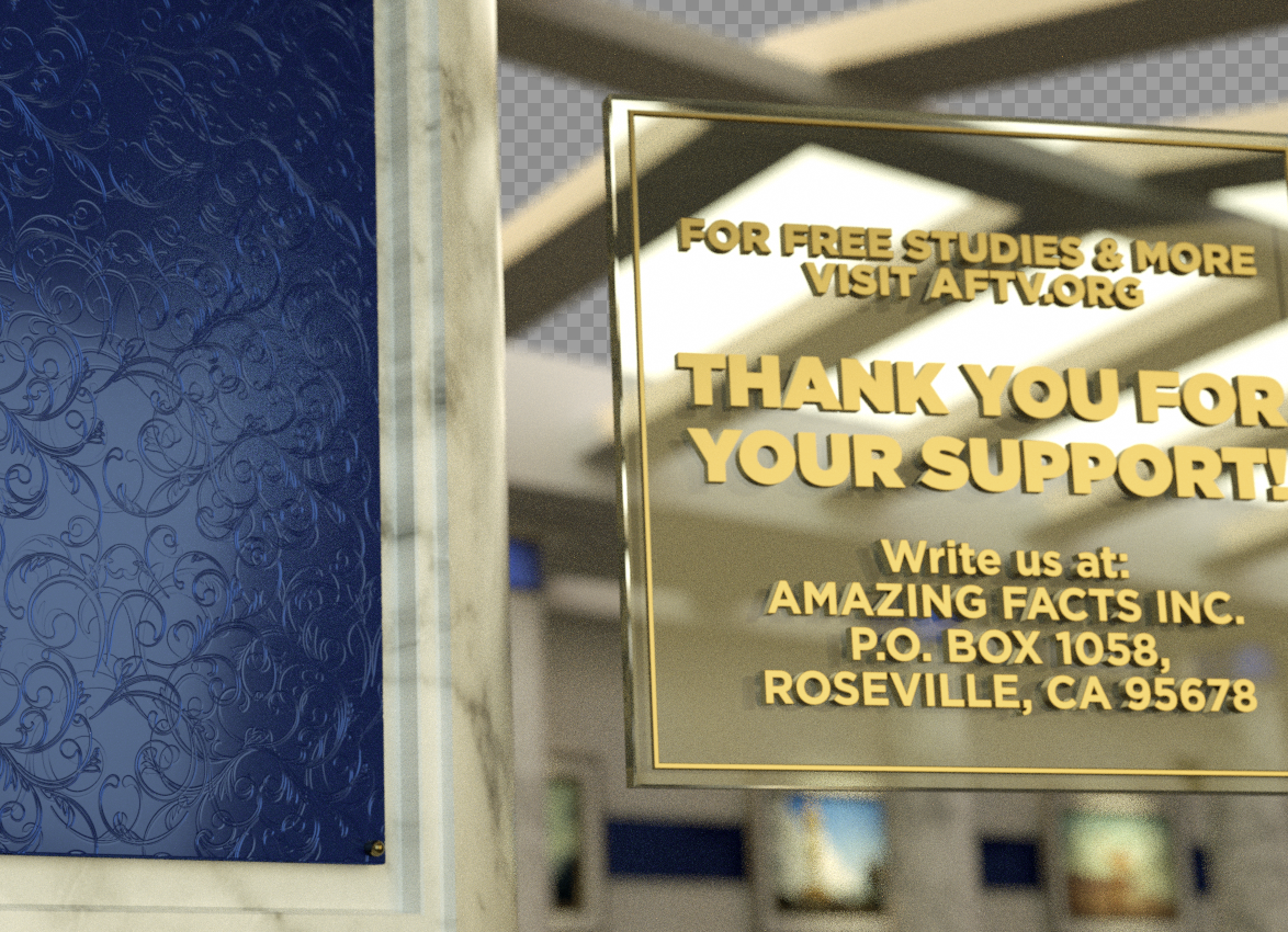

I'm working on a project where I need to remove the HDRI from the background. It works great, except that I have some glass in front of the background and am fairly clueless on how to get the HDRI background removed from behind the 'glass.'
In the attached image, you can see white areas behind the glass that have no alpha, but the areas that do are good.

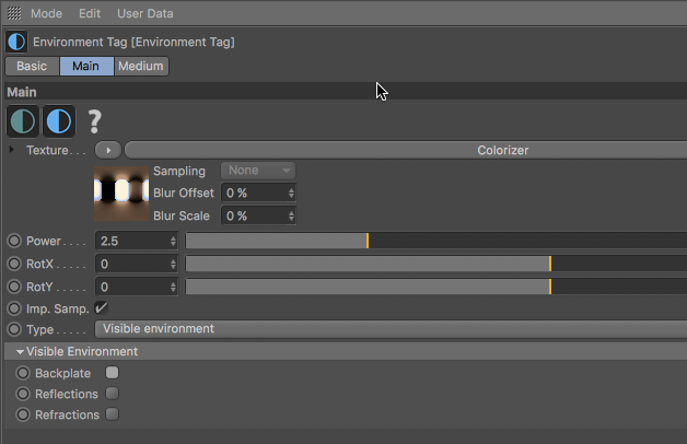

Hi Jim,
you can duplicate the Environment node, change it from Primary to Visible mode, and disable the Backplate and Refraction option.
In this way, the primary environment will be used for lighting only.

Leave HDRI as is now and plug in Texture environment (black color or white depends on what you want in your alpha) into the "visible environment" input.

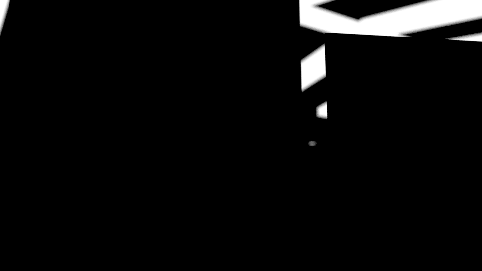

You can see what my alpha is doing by the attached image.
When I check the Alpha Channel in the kernel, I get this.
My Alpha
My Alpha
A single frame from the animation.

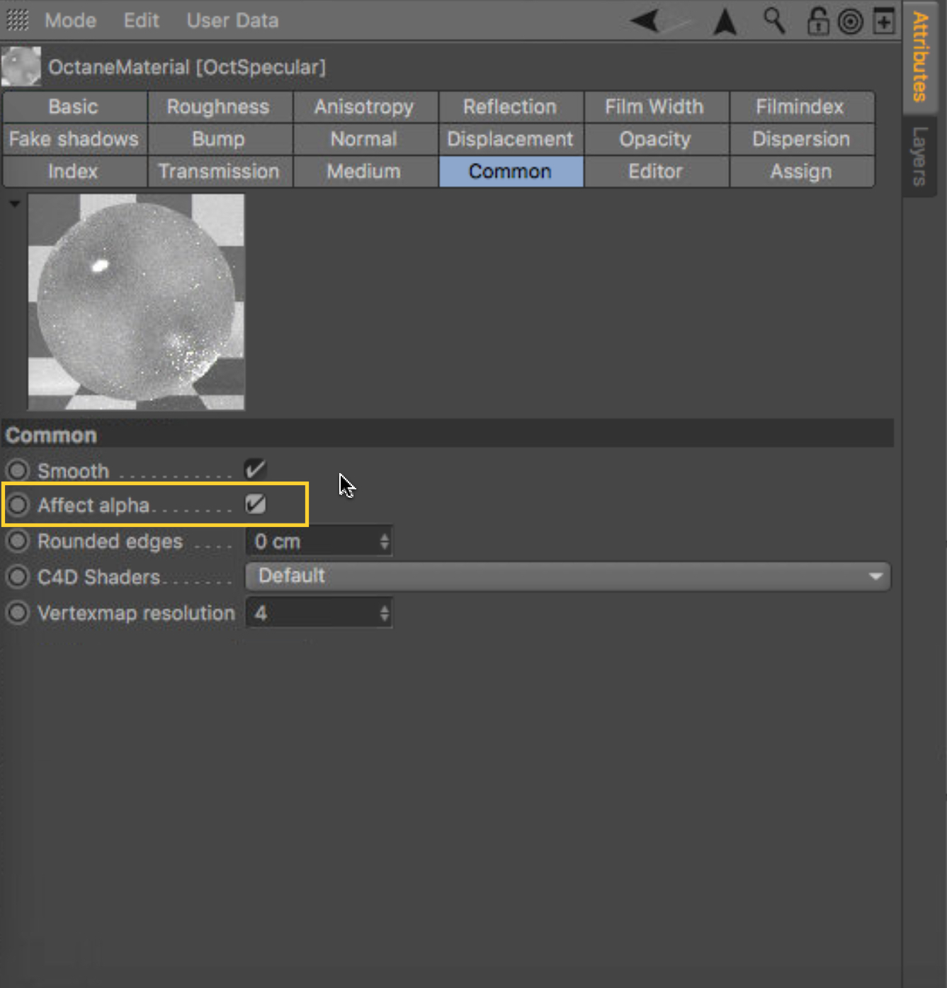

Posts: 10618
Hi reelinspirations,
if you need the alpha also on the glass plate, you need to enable the **Affect alpha** option in the Common tab of the specular/glass material:
ciao beppe
