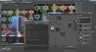

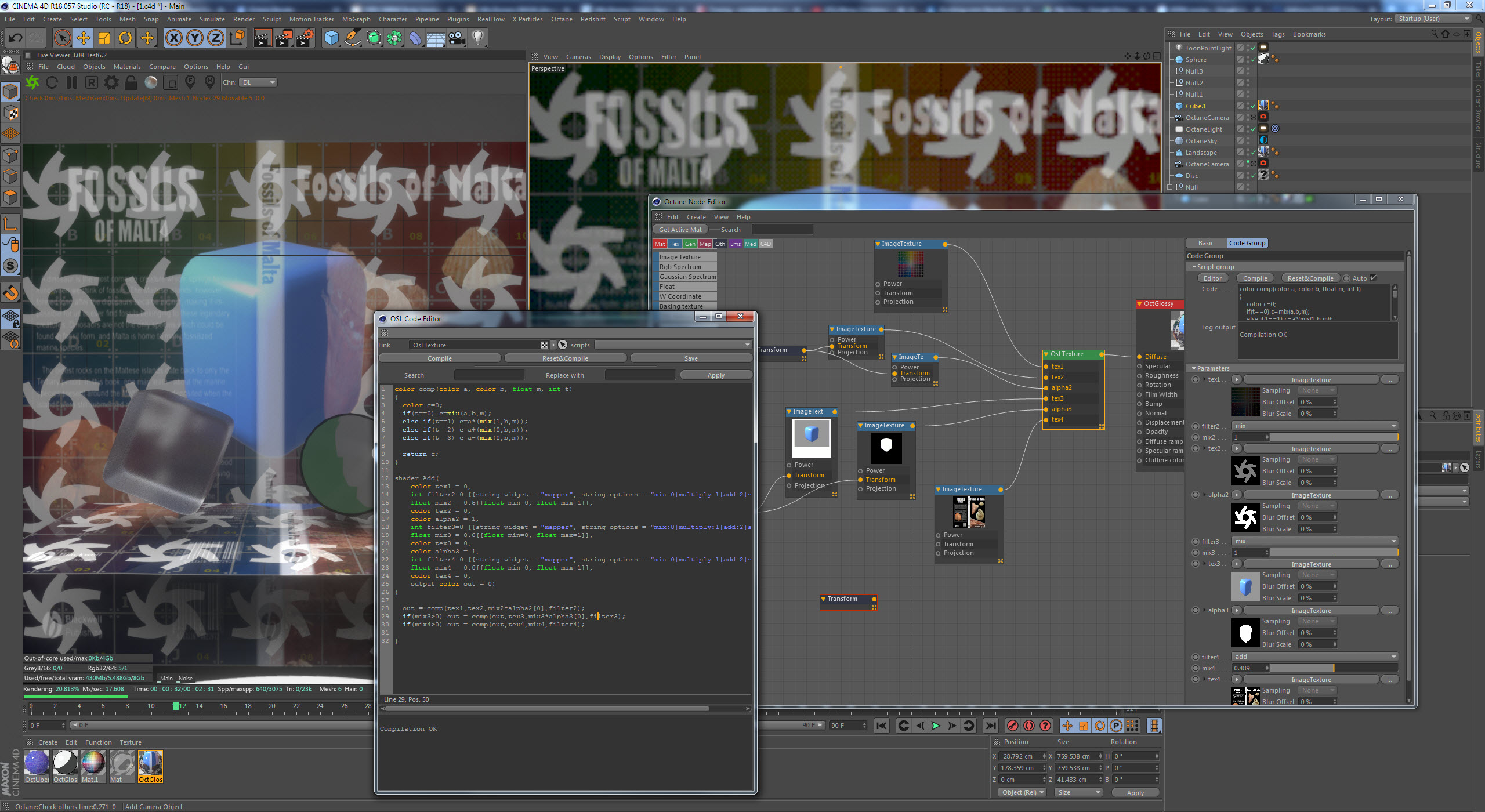

I'm fixing issues like you said that for sync. issues or missing types, etc... Here's a sample for writing a "layer" node. I'll publish new versions after weekend.enko wrote:@aoktar
