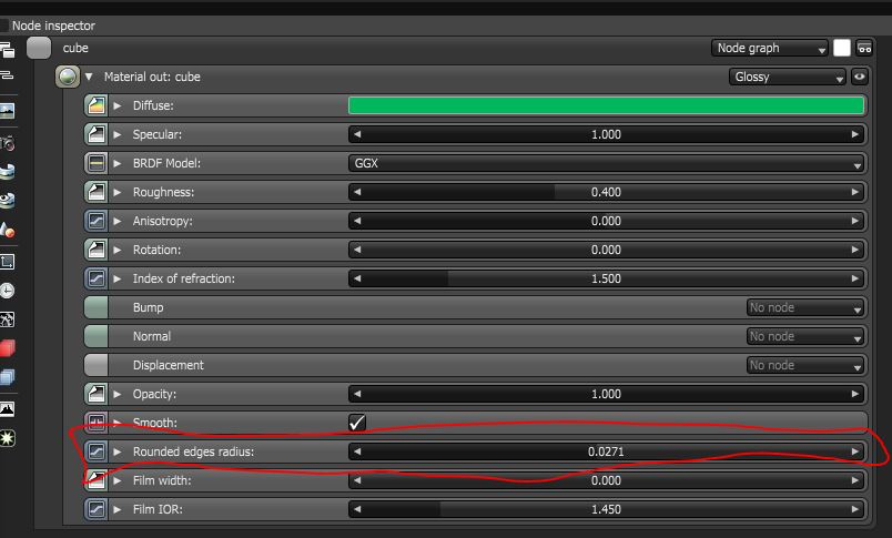

I work on Modo plugin and standalone version too. I`m a green user.
It was very hard for me to understand how rounded edges works in Octane. I`ve set value of that and edges were shattered. I`ve found on forum only one sentence about possible way to fix it and over 100 that it doesn`t work.
It works on standalone and Modo plugin version. It`s needed to check: "Merge unwelded vertices" option (I`ve attached screens). It`s not perfect but it works well on small values. I`ve tested it on 3.07 and 3.08 (test 6)
I think that should be on Documentation for green users like me.
