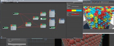

I have a car and want to instance it as a proxy but have the instances look different by having different materials applied to the car paint element.

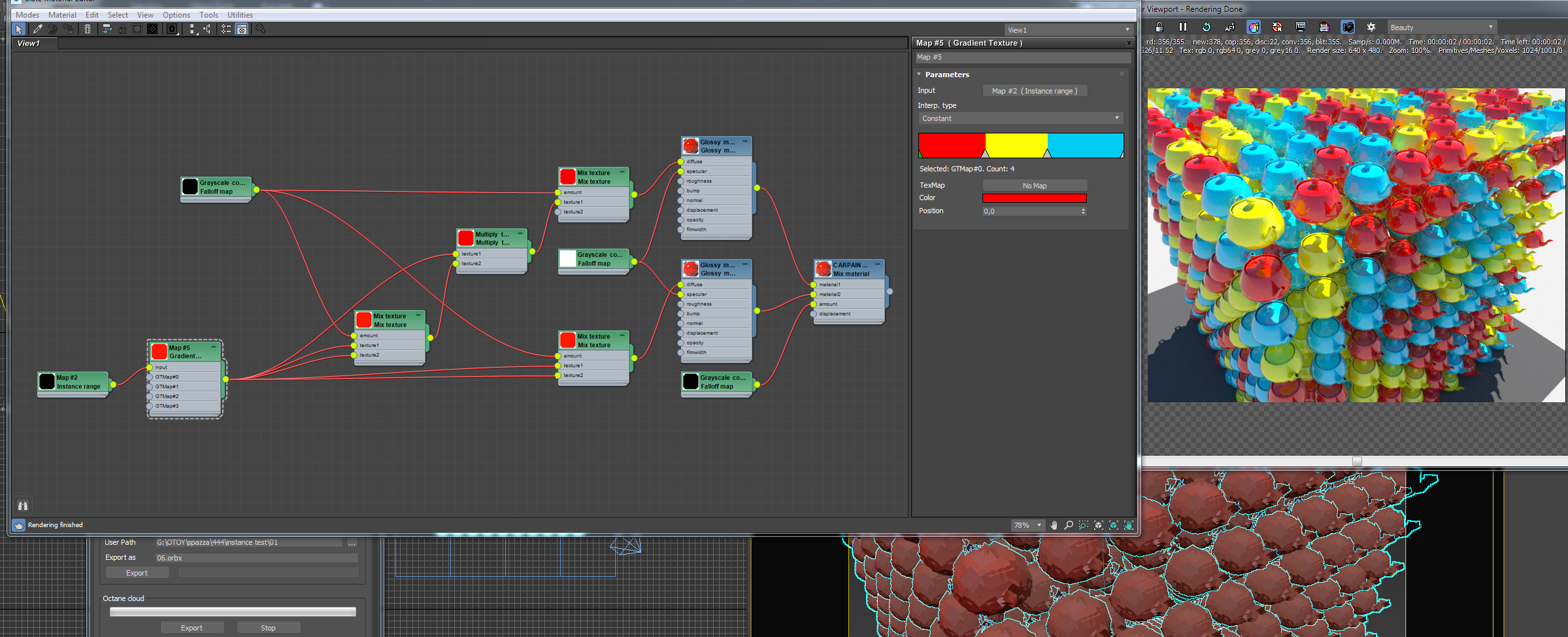

I can do it with the random colour colour map plugged into a gradient map plugged into diffuse but that only works for different colours.
I need to use different materials as some of the car paint materials are a mix of 2 materials and not just different colours and, very annoyingly, I can't just plug my car materials into the map slots of the gradient map...

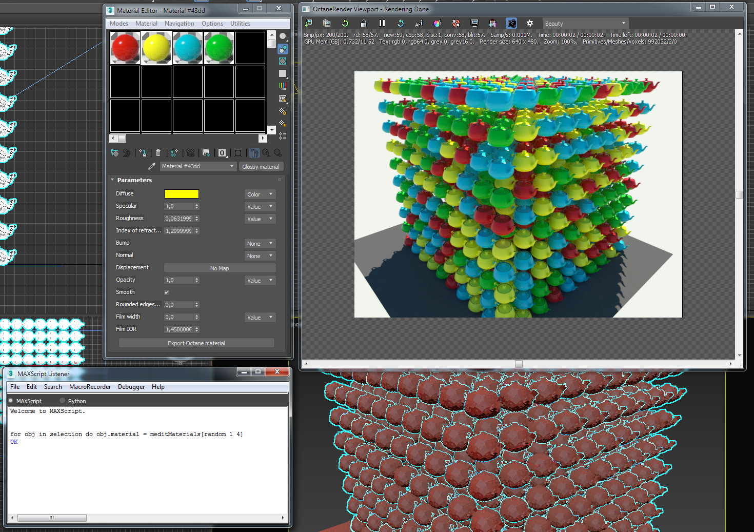

Hi Rik,
you could, depending on the case:
using istance range map node in your multimaterial carpaint or using a script to assign different material in your scene.
Select your objects and type in Listener this code:
for obj in selection do obj.material = meditMaterials[random 1 4]
Regards
Paride
