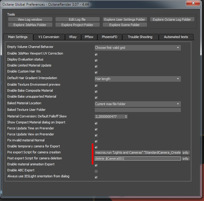

Anyone using Octane cloud to render from 3dsmax? Can you give me some pointers I can an error "Failed to create camera with m_PreExportNoCameraScript" when I hit export on the octane cloud tab in the render setup. Any ideas?

Hi spillstudios,
try checking in Octane Global Preference > Main Setting (attached screenshot).
Having said that, I advise you to export to SA via .orbx and verify that everything works correctly, then using SA send to ORC.
