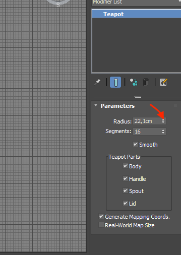

Of course, it's about dragging the value with the spinner arrows, as in the attached picture.
