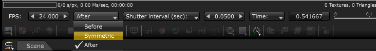

In Octane you can configure the position of the shutter interval relative to the current frame. Options are After, Before, Symmetric. This is how it's done in the standalone but you should be able to configure it in MAX.

3ds Max plugin doesn't have the opportunity to choose a motion blur direction (it is "after" by default in Octane engine).
I'm working on adding all the missing things to this plugin, so I will add this feature too in later versions.
